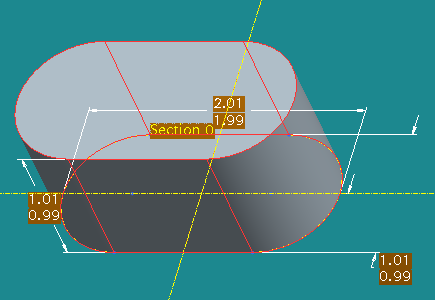

Could someone please advise me on how to get rid of the tolerance display in edit mode? Thank you!

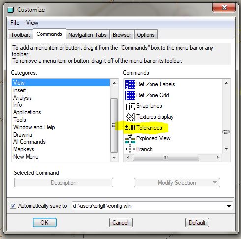

Kris,
Go to the Tools menu, Environment and uncheck the Dimension Tolerances setting under Display, then click on OK at the bottom of the Environment dialog.
This can be controlled with a config setting (options) of "Tol_Display" set to "No".
You can also use "Tools" "Customize Screen" to add a button to your toolbar to toggle the tol display on / off.
(drag the "Tolerances" function / button to an appropriate toolbar in your Pro/E screen so it is there as a toggle)
Erik

KrisR1-VisitorAuthor
March 27, 2012
I'm going through the PTC Precision LMS tutorials and every single one of the models I open has limits set - I can't change dims as instructed through the tutorials. I'm assuming this is template driven but I do not know how to shut it off.
