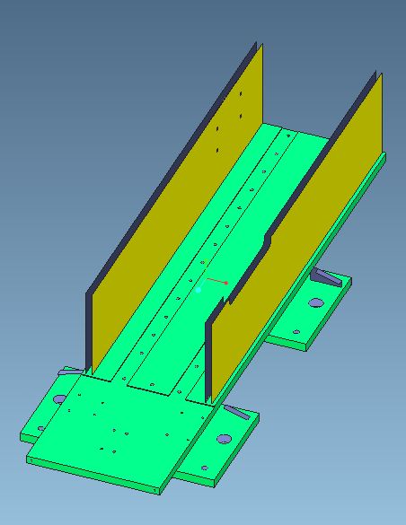

I have created an External Shrinkwrap to illustrate parts and fabrications bolted this feature. When I created the Shrinkwrap, the preview shows something different than what is actually there. See below.
Preview Shrinkwrap
Actual Shrinkwrap
Four of the gussets on the fabrication are missing. I patterned these and I'm wondering if that has an affect on the Shrinkwrap. Is there any way to have these gussets shown?

Please provide details about the Shrinkwrap settings you are using.
Have you tried using Solids and increasing the detail level to about 8 or even 10?

Hello DHLewis,
The Quality Level was set to 1, I increased the level to 5 and it looks fine now. Thank you again for the help.
