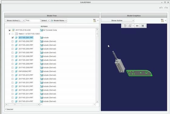

we are working with Creo3.0 M120 and we are using the simplified representations quite a lot in assemblies to create some partial BOM-tables in drawings or to make our large assemblies less "heavy".
Now we have one part in an assembly which won't be excluded in the simp reps of this assembly.
In the screenshot below you can see that the part is selected and put on "Exclude". But whatever we do, the part always stays vissible in our assembly and drawing.
Does anybody know what the problem might be? We had this problem once with another part, but at that time we were not trying to fix this problem...

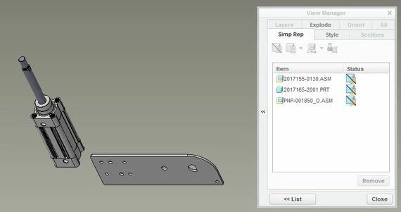

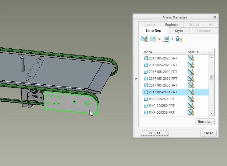

October 26, 2017
I've tried this, but 2 parts are still vissible, even when they are on "Exclude":
Even a forced regenerate in the model-player isn't giving any solution...

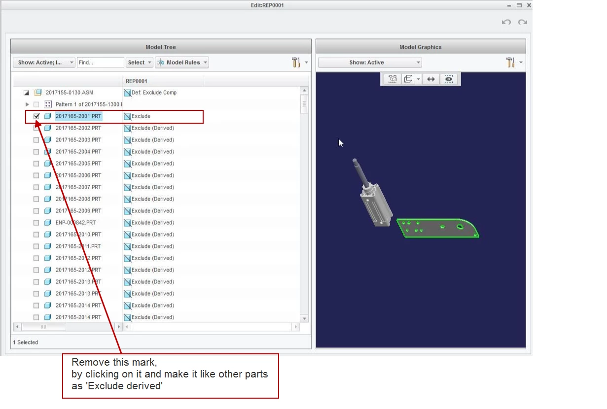

October 26, 2017
By the picture it should not be appear in the model and drwaing.
But, Please click on that mark in front of the part, so that mark will be gone.
And it will become ''Exclude derive''
hope so it will work
That mark arrow in front of the part has to be gone.
Please try it
See attached picture
