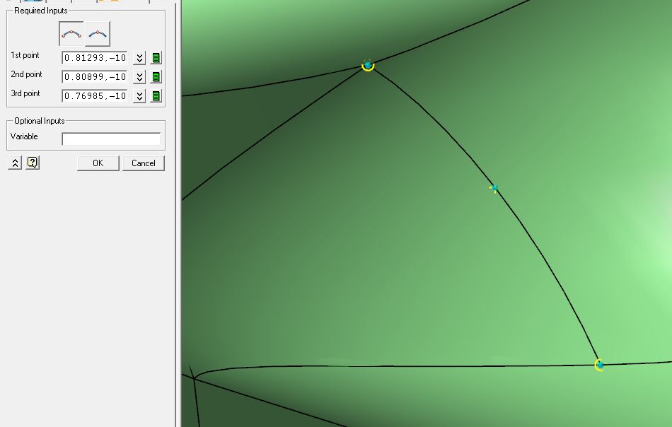

I am building a model from scratch based off a customer model.
I need to know what the radii values are so I can best duplicate sizes.
The measure tool is not recognizing the customer radii as a diameter type dimension.
Besides intersecting a plane with the model and finding the value in a sketch is there a way of easily determining what the radii feature's size is?
February 26, 2015
This happens to me sometimes, usually I draw a sketch on the part to determine what's the dimension of the diameter.
pimm15-MoonstoneAuthor
February 26, 2015
Raphael,
This works in some instances but there are some times where the geometry is at a very odd tilt.
To develop a strange tilted plane to get a sketch that you can approximate a radii is a lot of work to go through to get a radii is an awful lot of work to get a radii value.
I'm hoping there is a quicker way to get this value.
In our other CAD system we can get this measurement by selecting 2 end points and a middle point.
February 26, 2015
Thank you Steve!
I didn't realize there was a drop down that had the radii option.
I thought the diameter option under the summary tab was the only choice.
