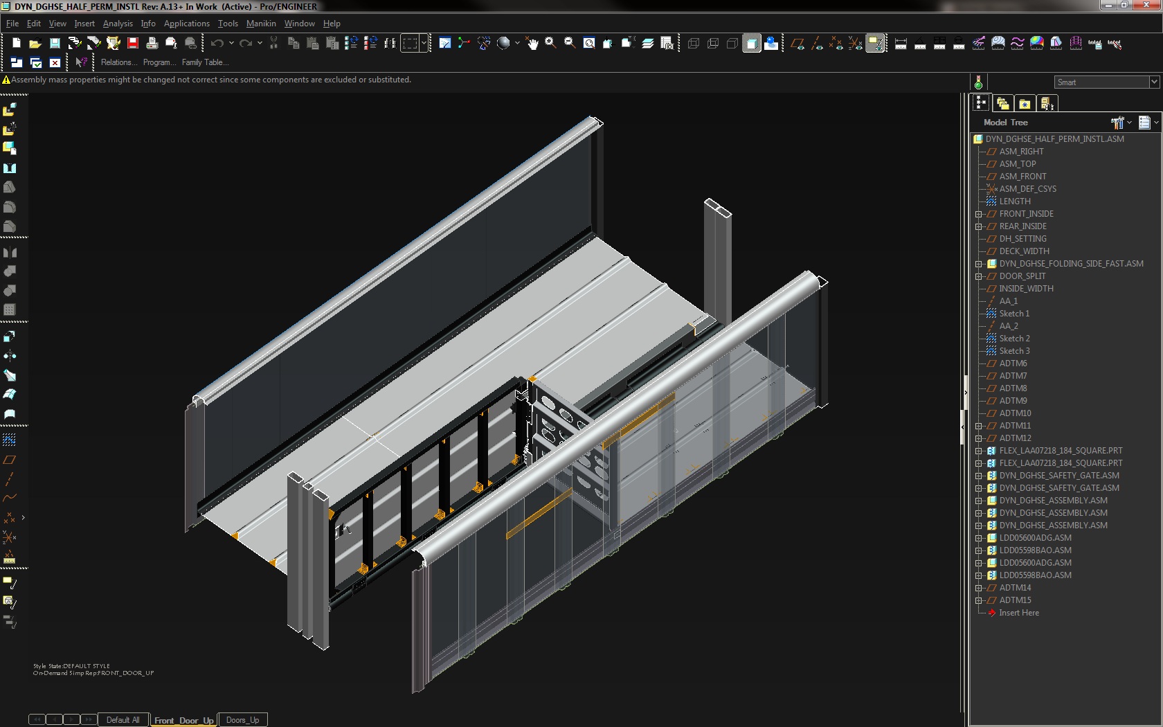

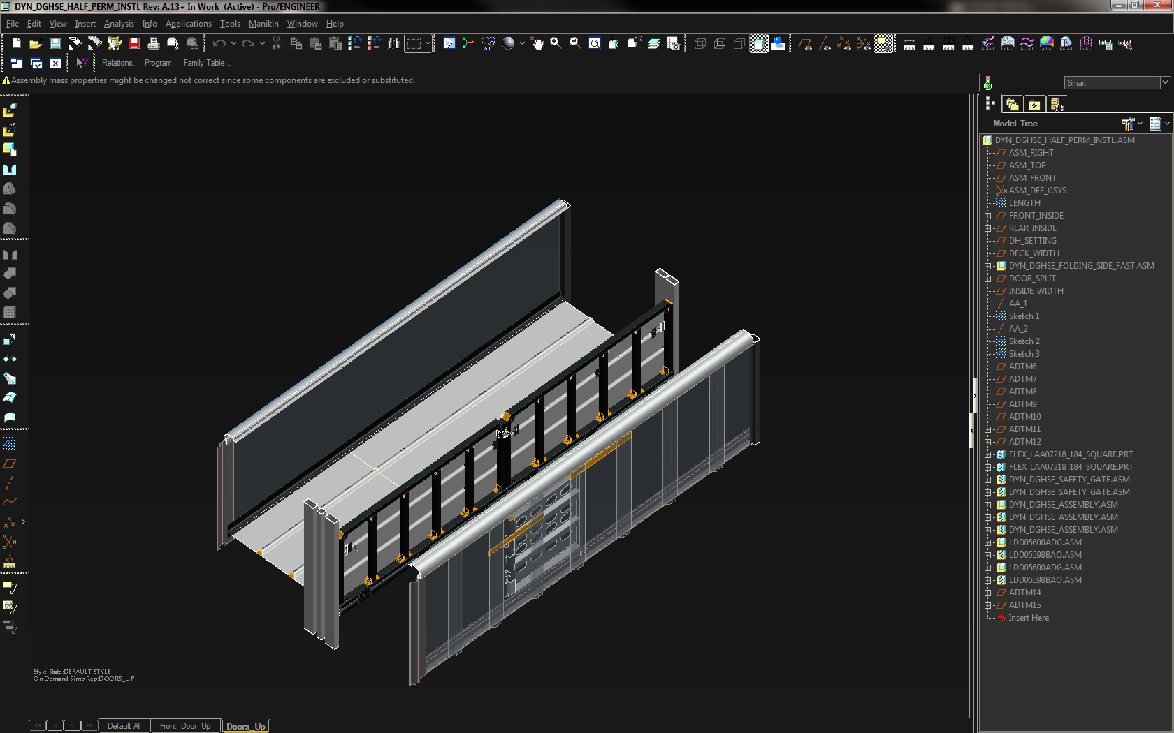

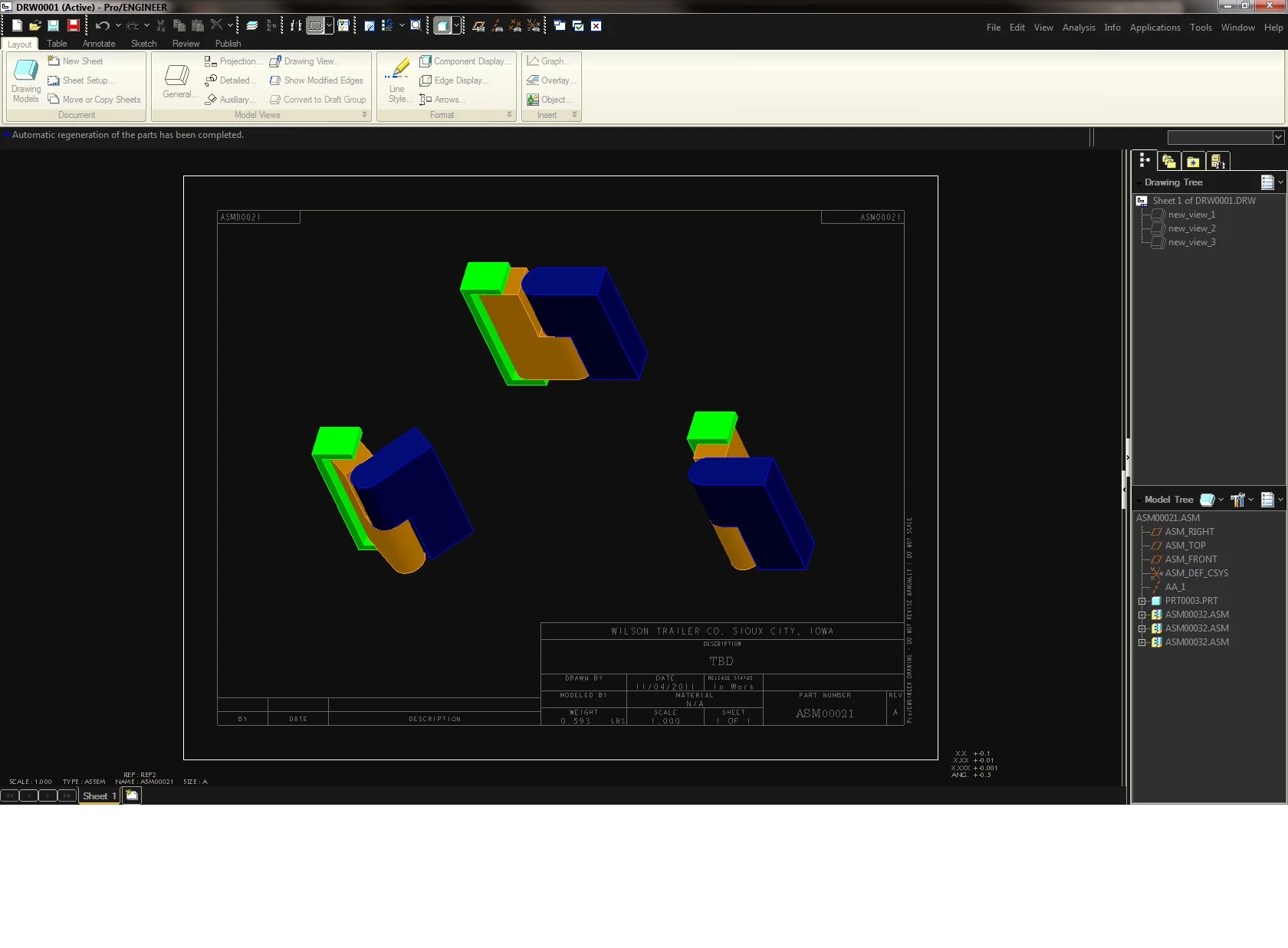

I have a dynamic assembly that I need to show in 3 different settings. I inserted the subassembly in 3 times and applied flexibility to show each insert with different settings. I created 3 simplified reps to show the 3 different settings in the drawing and to show only the weight of one of the inserts on the drawing. The problem is I'm having 5-15 minute regen times. The subassembly alone regens fairly quickly. Any tips to dramatically reduce regen times or a completely different method of getting the same outcome.
The attached picture is a simple example of what I'm doing.

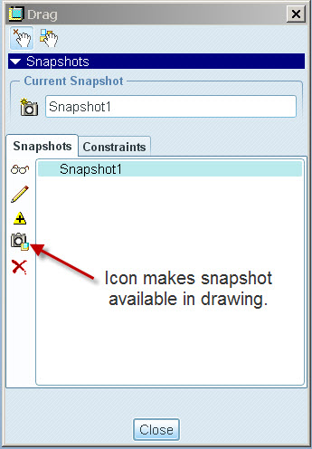

Since it is a dynamic assembly, give this a try:
Lee,
All you need to do is take snapshots of the positions you want. You may then pick the icon shown below in the dialog box to show the view on your drawing. If you want to rename your snapshot, you need to do so before the icon pick.
Once you are in the drawing, insert your view, open the drawing view diaglog box, then select View States, and check the Explode components in view box. Select your snapshot, and it will stay that way regardless of how your assembly position changes. Hope this helps.
Tim

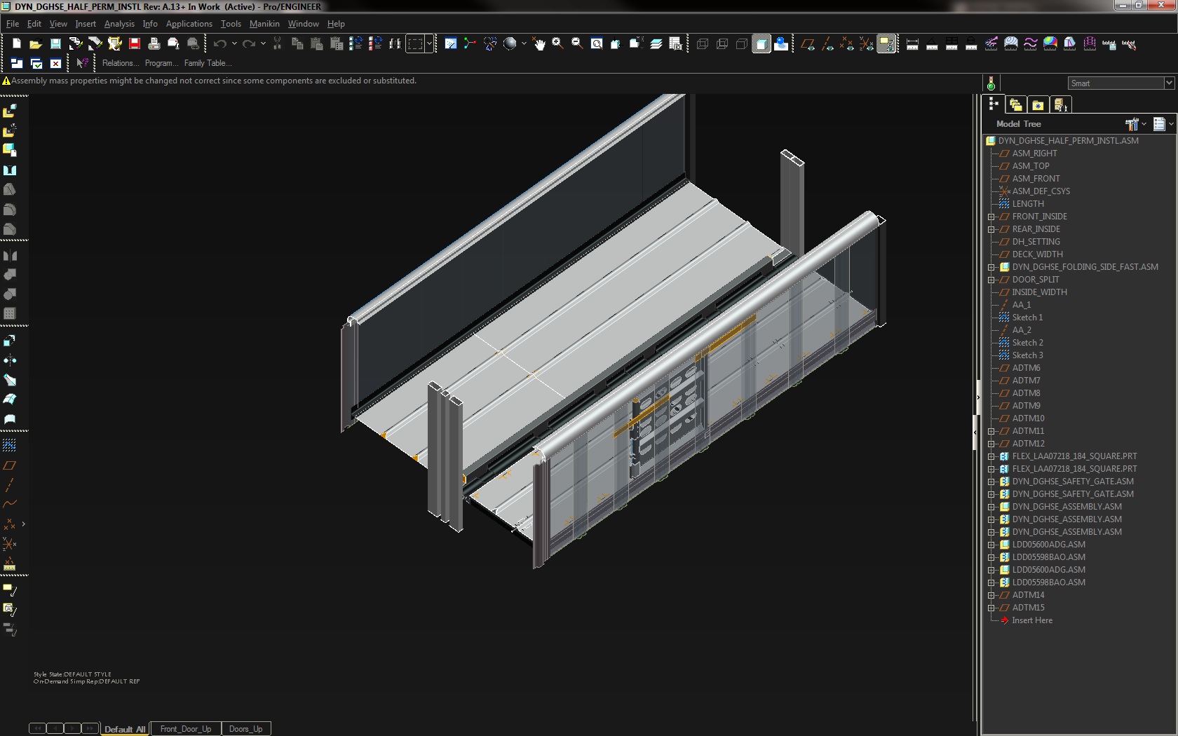

December 1, 2011
Height, length, and widths change and new components come in and out.
