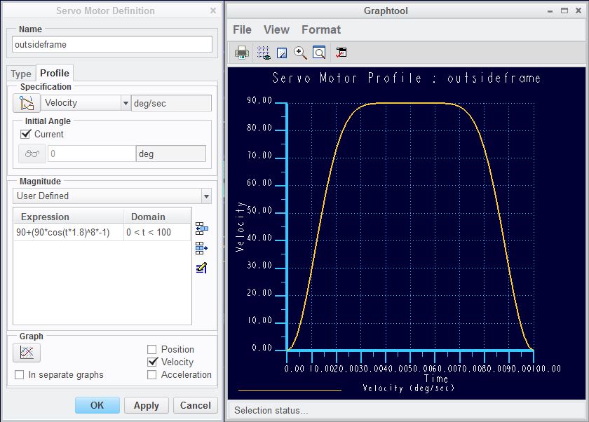

If you "unground" the shaft and add a different ground feature (a fixed shaft for instance), you could easily automate a presentation profile by making the hub a motor and one of the blades a motor.
You might also enjoy this resource:
http://www.sharptechdesign.com/Tutorials/Mechanism_WF2/MDX_WF2_TOC.htm
I also like this motor profile for acceleration/hold/decelleration:
