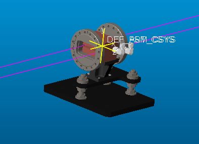

Long time UG/NX user and have been on Creo 2.0 for about 6 months.   Long story, but I have several parts in a -1 assembly "floating in space".   In order to avoid external references to the next higher assembly, I created a skeleton part in my -1 assy.  If I understand the skeleton theory, one way is to import quilt surfaces from the next higher assy and I can use them in my skeleton to position my parts to.   I think you can also use csys (coordinate systems).   Since my parts are already in the right postion, what I tried doing is creating csys in my skeleton using my part in my assembly.    I have a green model status, but if I run ModelCheck, it tells me I have a circular reference.  Is a circular reference ok in the context of a skeleton or is there a better way to create a csys in my skeleton from the current positions of my models?  Thanks

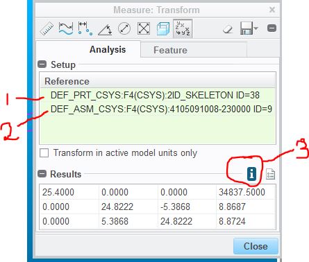

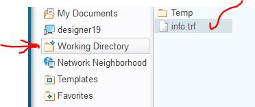

Alright, say you have a components location and need to add it to the skeleton.

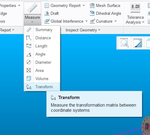

Measure the distance from the default csys from the skel to the component and save this info.

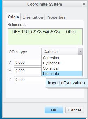

Then open the skeleton and create a csys. Select the same default as you did in the assembly.

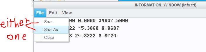

Now change the type to "From File".
This file will be located in you working directory. Then complete this action.

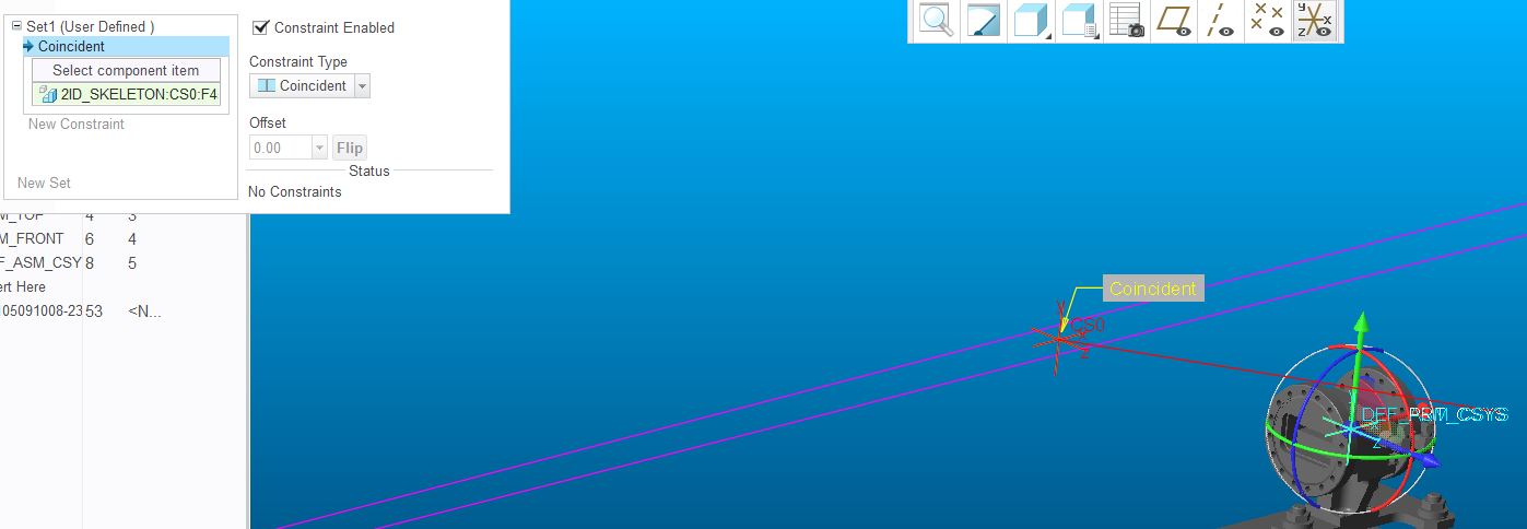

Now you can go back into the assembly and redefine the placement of the component to use the newly created csys.
