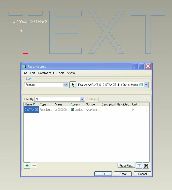

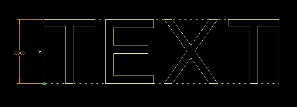

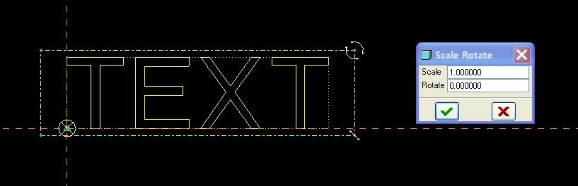

April 20, 2010
Here is what happens to a sketch when inserted into a part using the ProE default unit system (Inch lbm Second) at a scale of 1. The value in the sketch is a ratio.
