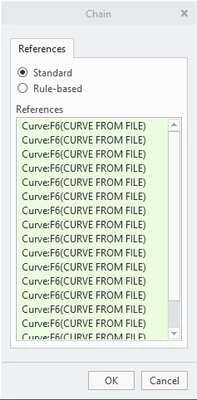

May 26, 2022 6:23 PM UTC
By making test with a selection of 2d Curve from a import, select the fist line, then open immediately this selection windows. This help with the rapidity that the curve are selected.
