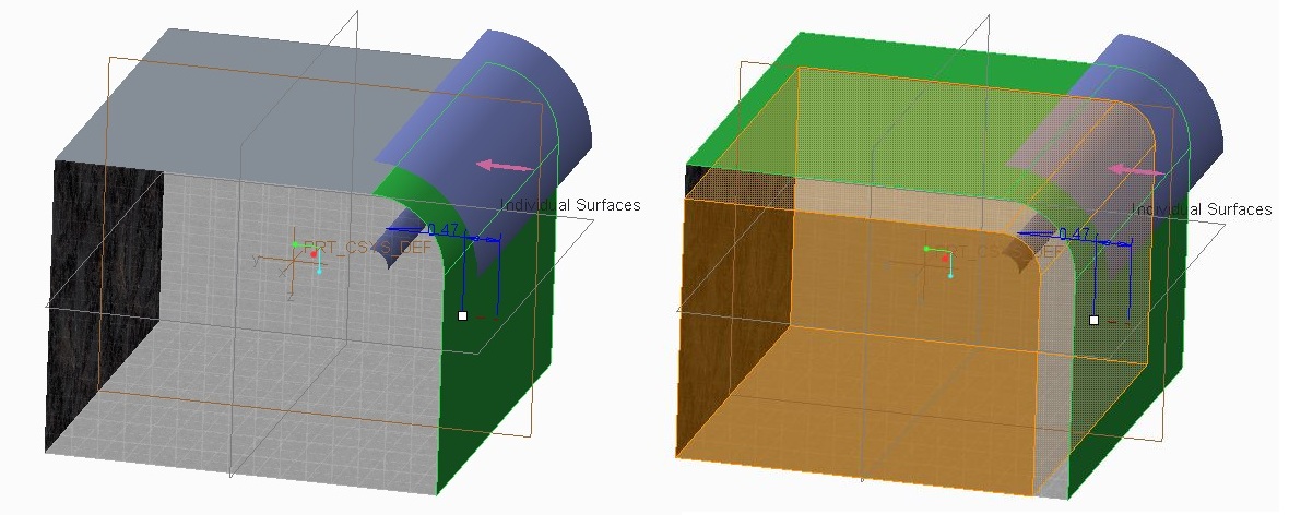

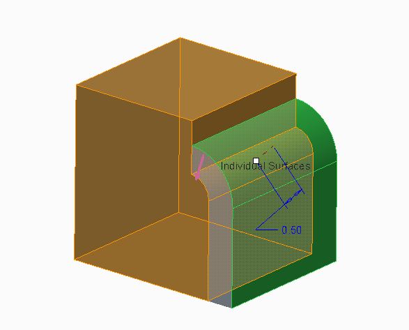

You are right, this does seem to be a bug. I can select the wall, fillet, wall and it works fine, but remove one of the walls and the feature fails. Care to report it as a bug?
Confirmed in Creo 2.0 F000
As an indiviual surface, the fillet (round) does offset. I get the failure in either direction if the round is one of the edge boundries. It appears to require bounding on both straight edges.
Left: Offset edit with only 2 surfaces selected; right: additional surface selected. Both have preview enables.
June 17, 2012
It doesn't know how to deal with the tangency. It should just default to a shear but it doesn't. If you have a non-tangent edge, it works fine. Still something that could use an enhancement.
The issue is not limited to rounds. It "fails" even with a sketched tangent radius.
