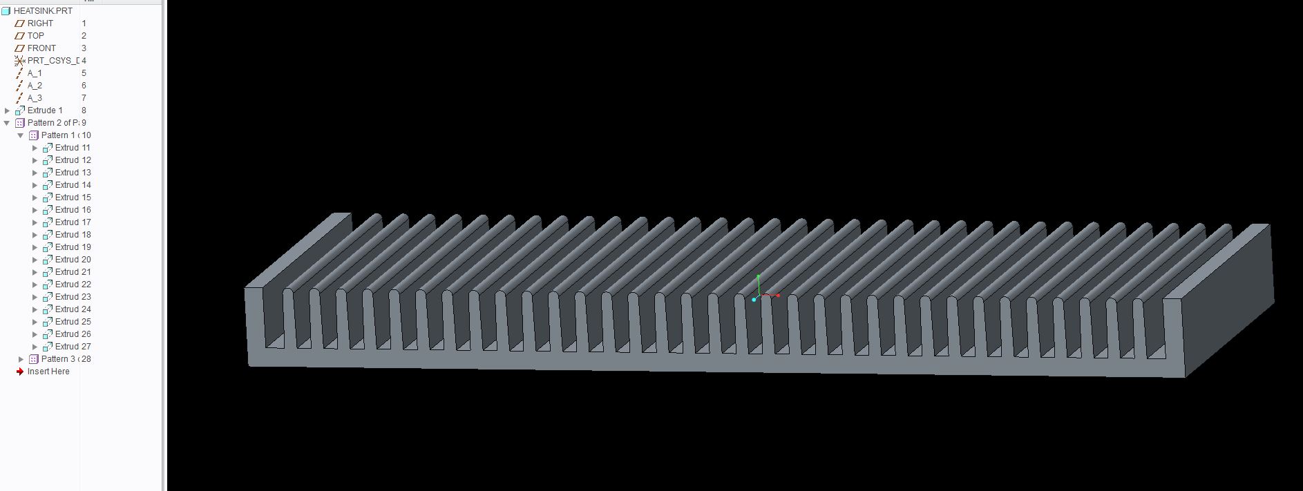

Absolutely not. But I understand the thought process. I had the same ideas back in the day coming from AutoCAD and Mechanical Desktop. And that was back when there was almost no pattern tools in Pro.
This is very simple modeling. Like seconds of modeling, and a few minutes to figure out what you actually want your profile to be. Just a U shape extrude for the base, a extrude profile for the fin and pattern it. If you want radii and other features on the fin profile, just group them first and then pattern.

If you are trying to make this in one feature, then you will have all the difficulties you have run into.
For parts like this I find it easiest to create the base as one feature, a typical fin, and then pattern the fin.
