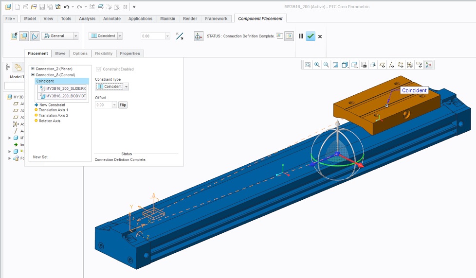

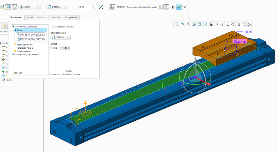

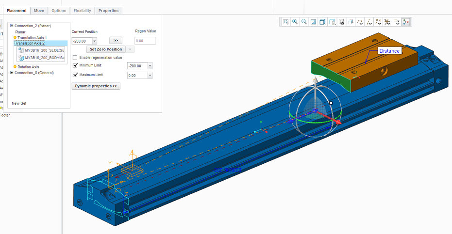

I use planer in one set and general in another set to fix sliding mechanisms. If you see in the second image you will see one of the arrows of the planer mechanism icon is highlighted in red. Is this the thing you were after?

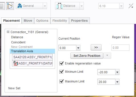

Make the two distance constraints. (not offset planes needed)
Select the mechanism button and it will default to General.
Select Translation 1 and pick your movement references.
Set your zero/regen and limits.

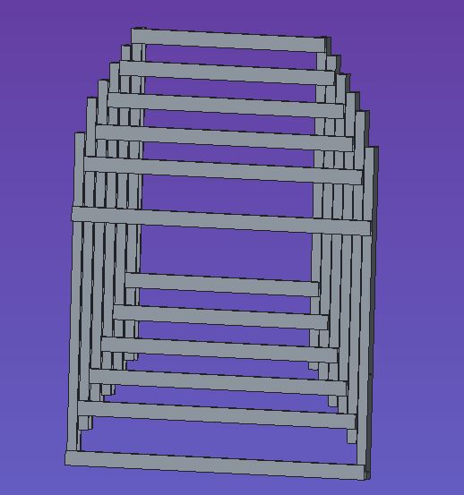

December 9, 2016
Here is a multi stage slide extension, I created a couple days ago, that was assembled with General mechanism and works well.  Each stage has to be constrained to the previous stage, not the first.
