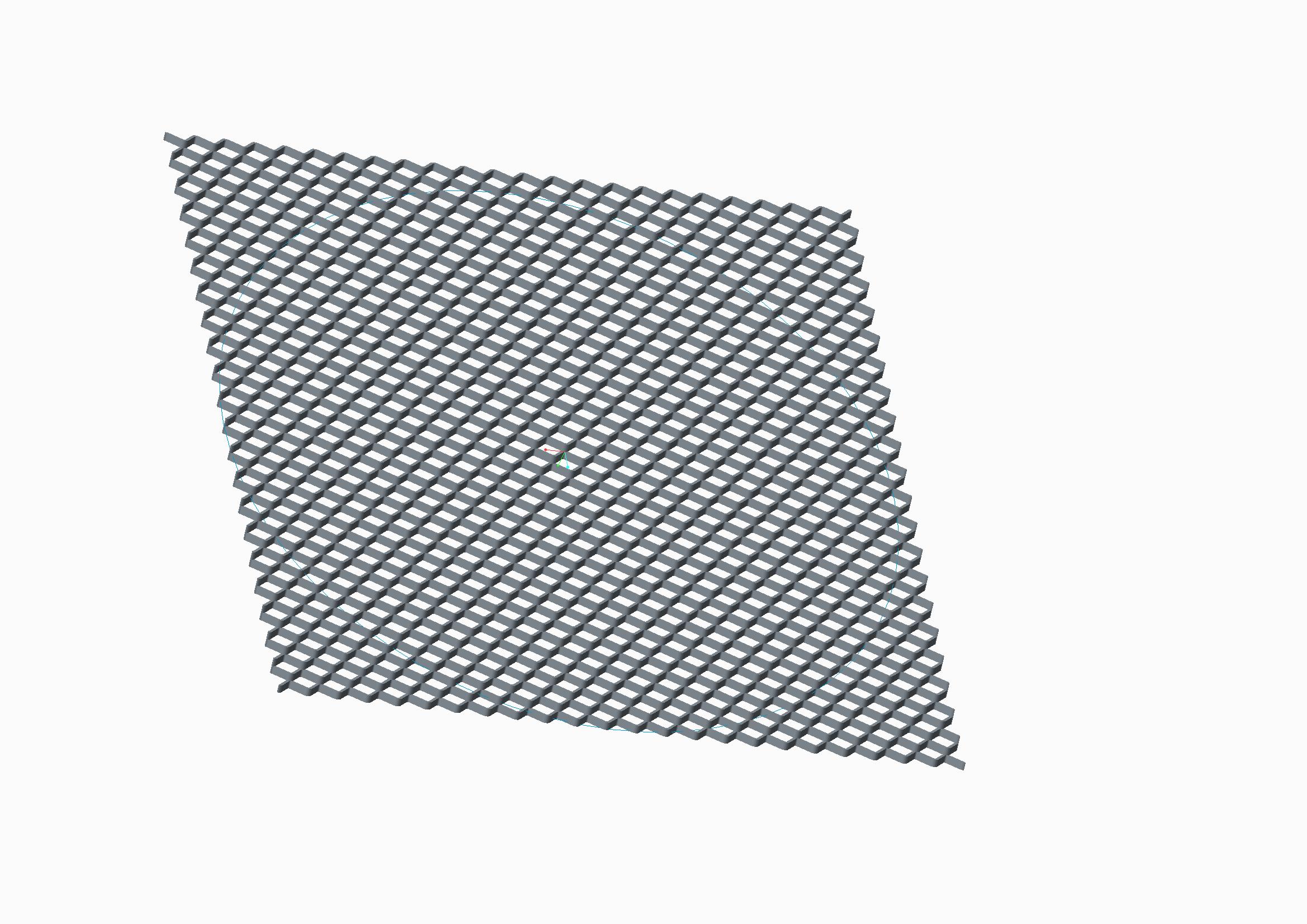

Hi all,
I modelled a flat "expanded metal" grid as a solid part:

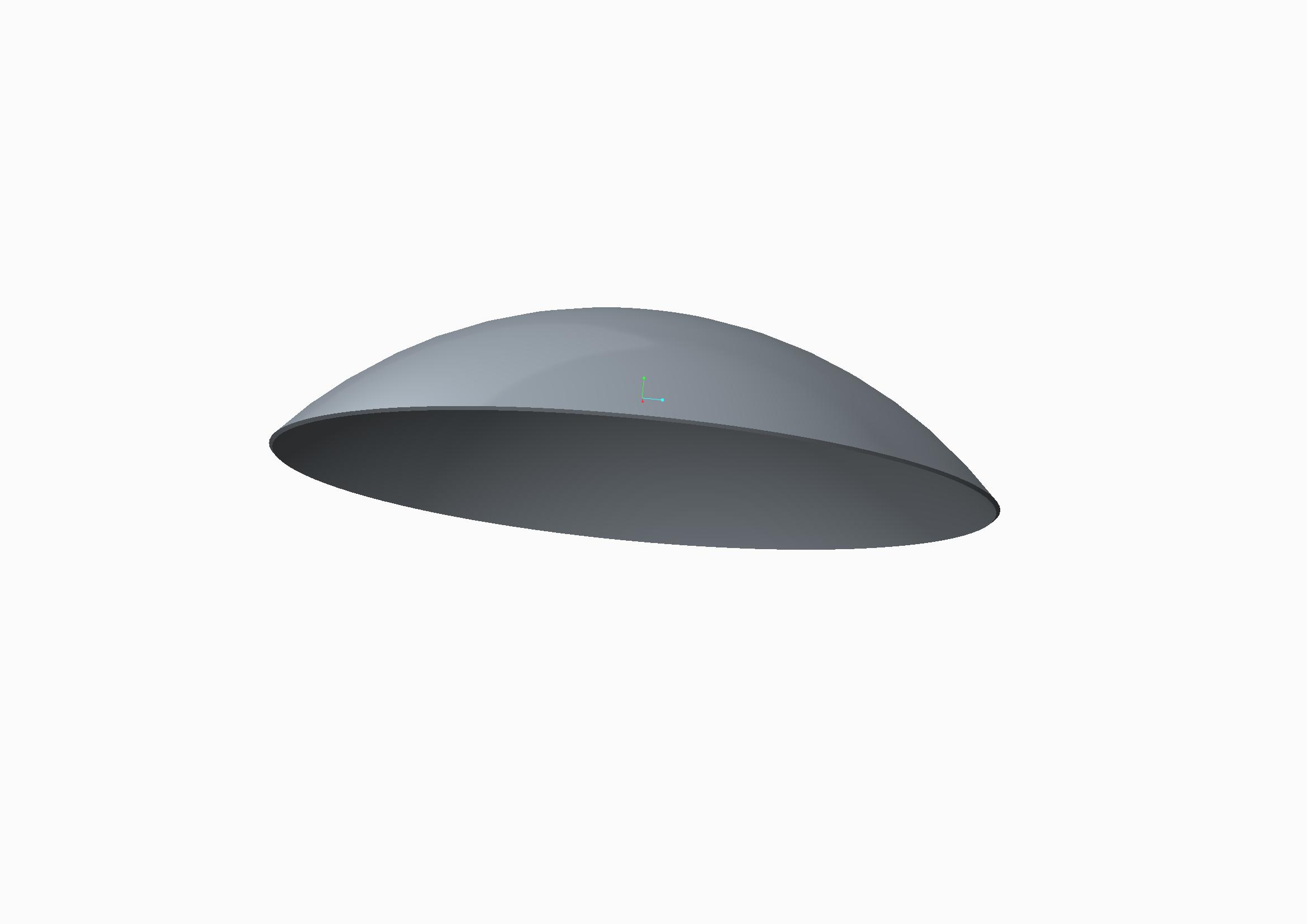

Now i would like to deep drawn it in order to give it this shape:
I already tryed the toroidal bend feature but I think I can only bend it around a trajectory (2D) and not deep drawn it (3D deformation).

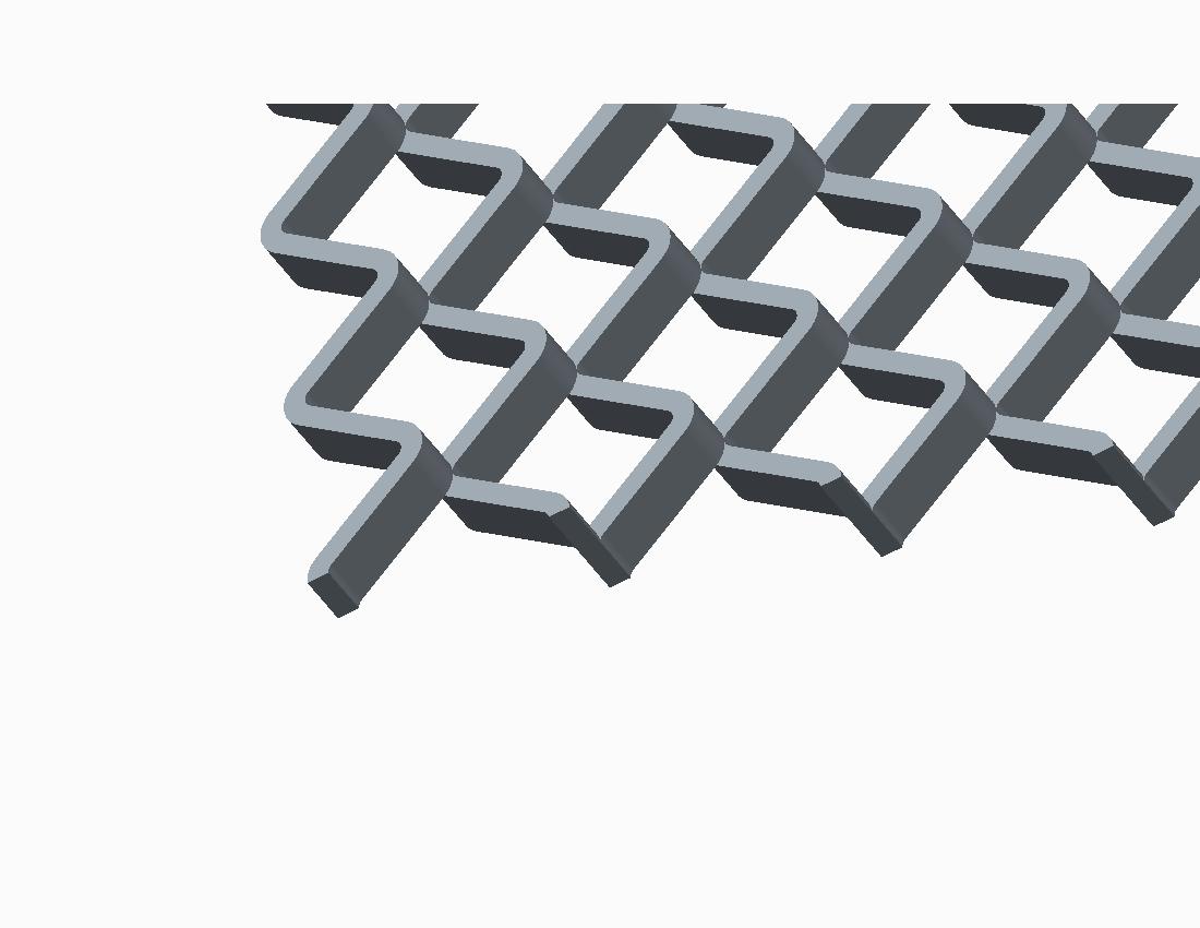

Thanks for your reply.
So I understand that Pro/E doesn't permit to lay (as a sheet) a solid geometry.
Regarding the suggestion to use Sheetmetal, I think it is not possible converting the original geometry because it hasn't a constant thisknes. See the image below:
The only feature I considered to use is Flatten Quilt / Flatten Quilt Deformation, but I think I cannot warp the geometry on a spherical surface (only cilindrical..)

Try to convert it, what do you have to lose? The sheet it's made from IS a constant thickness, and remember that sheetmetal isn't going to see thickness as you do, I think it'll see it as being constant, which, in one way (the actual material thickness), it is.
Good luck!
February 26, 2014
In sheetmetal, you need to be able to form it in two operations.
1st, the mesh itself uses the thickness as the narrow width of the section. The VVVVVVV shape for each course is a form; stepped for the second course, and if all works out, patterned. Then you would try a dome shaped form to dome the part. Then trim the diameter.

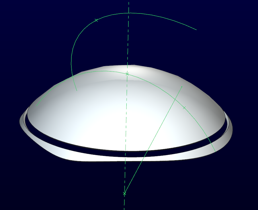

March 3, 2014
March 3, 2014
Oh, Frank... at least post us a picture and a synopsis
March 3, 2014
Frank, your method is close and a lot more controllable than the Warp feature.
You can see that the edges still deform (the process is still X-Y "linear" rather than spherical).
In this case, I use a 10" disk, .1" thick wrapped on a 5" spherical radius. At the tighter bend, the difference becomes more notable. You can see the variation beyond the revolved cut.
However, with the revolved cut, you can definitely get this part a lot closer than the Warp feature does with a whole lot more control.
Creo 2.0 full versioin attached.
