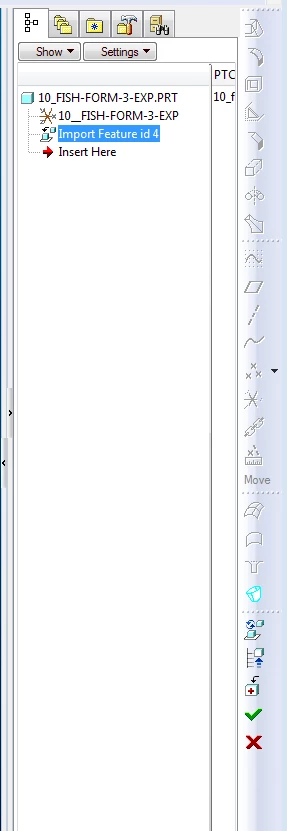

September 21, 2012
I guess this would be Summary Part 3.
Ron Thellen added this (image attached):
