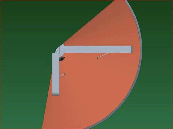

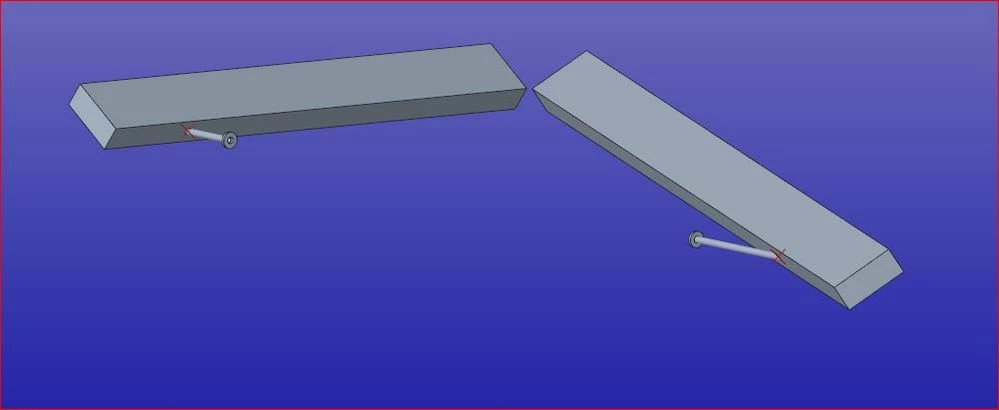

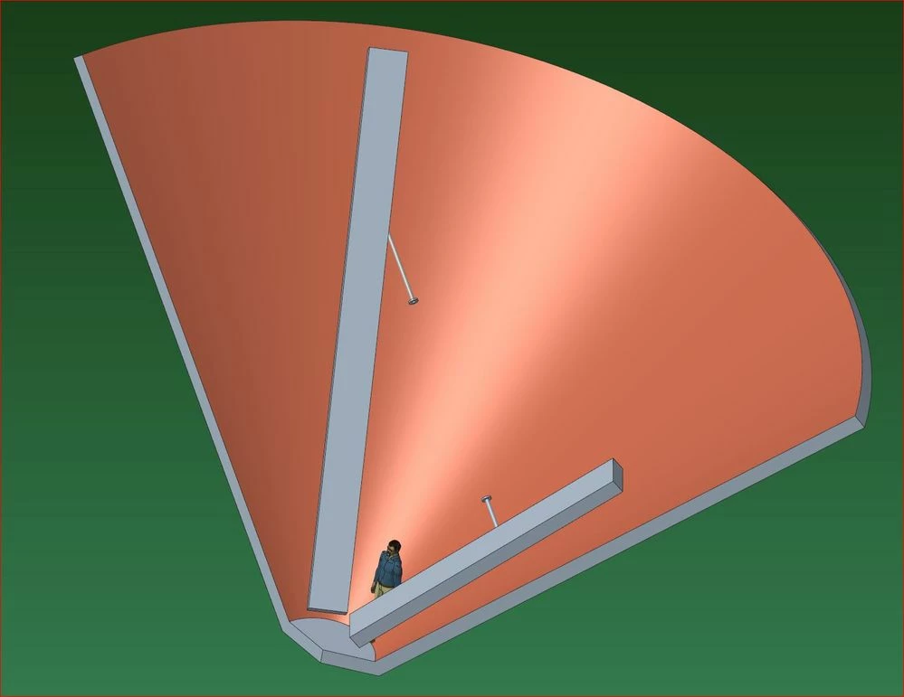

I need help solving for the cuts and constraints for these pipes.
I just can't quite figure out how to go about laying out the parts to make the cuts.
I need to start with just a regular pipe and do part level cuts, then assemble them.
what is the process for figuring these out.
I wll attach the layout part and some pics that might help explain.
I want to do this with out assembly level cuts.
 here are more images
I have a working skeleton model I just want to lay out piece details and the orientations

No bolts just to square beams that have a flanged pipe brace between them.
I am trying to do this so I can lay it out for the shop
July 14, 2017
I admit - based on your powerpoint slides and from the messages in this thread, I couldn't figure out what you are trying to do.
I guess you are trying to make a miter cut in the pipes so that you can weld them to the square tubing such that when you bolt the flanges together you will have an L shape made out of square tubing and braced with the flanged pipe?
