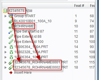

A moment the option "pipe_solid_label_format" can be either “auto” to follow Windchill schema, “default” for the hard coded value or the sum of the restricted parameters (SIZE, SPECIFICATION, MNEMONIC, NUMBER, INSULATION).
I need an additional parameter like “ASSEMBLYNAME” as shown in screenshot.
If we create pipe solids we alway must insert the assembly name manuel.
Is it possible to insert this parameter for option pipe_solid_label_format?
