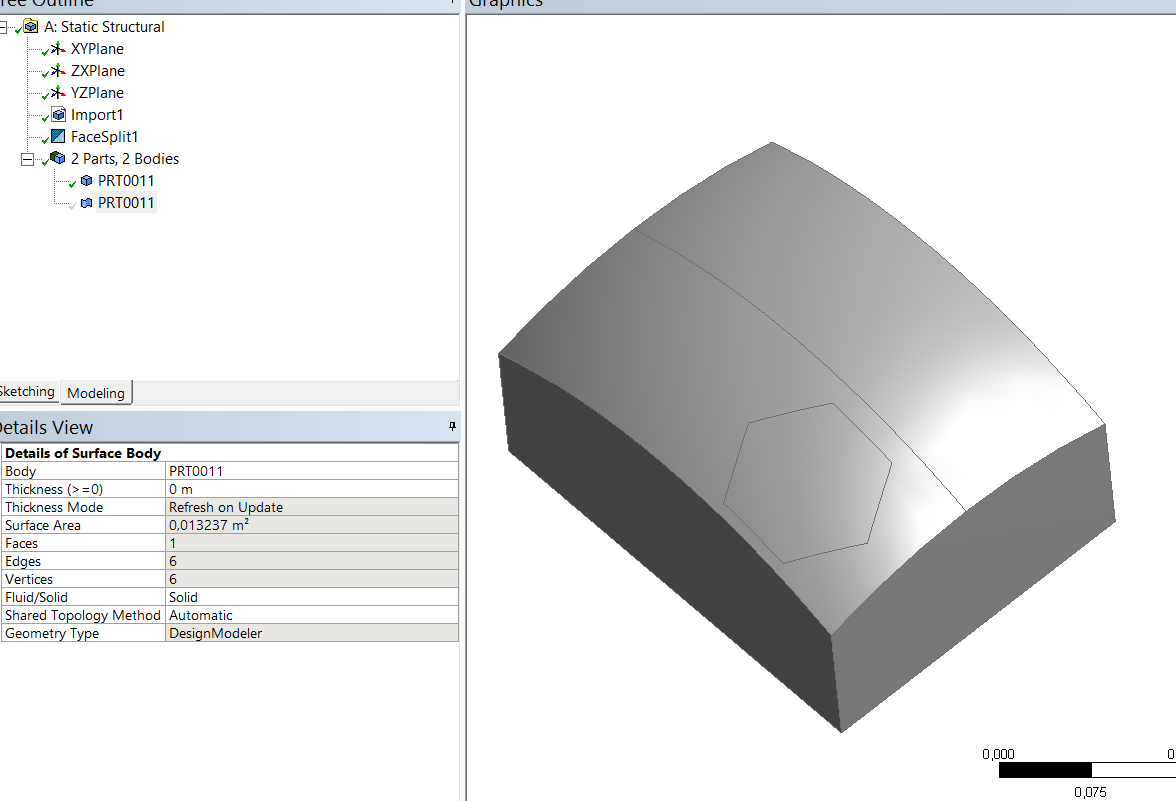

I just succeeded with a variant of your last suggestion. I have played around with a lot of alternatives, unfortunately I can't remember the exact steps but it went something like this. Open the model in FEM mode. Being in FEM mode, with your surface regions completed, click "Save as" and choose iges as the file type. This is now imported to ansys with the proper split of surfaces...

Another way is exporting solid model with surfaces patches where you need to load or costraint and use command FACESPLIT in Workbench.

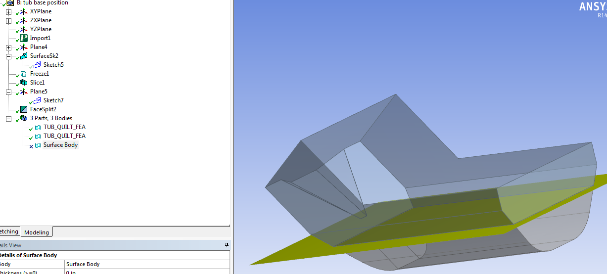

you create a slicing sketch on a plane in designmodeler. usually a large rectangle , create surface from sketch.  Freeze both surfaces.  Slice using surface. Use the plane you created as the tool.  You will now what 3 bodies.  Suppress the cutting plane.  You will have to bond edges in Structural.  I just learned the hard way.  Completely different methodology that Creo.slice.PNG

That assumes one has a Design Modeller license
Regards
January 11, 2016
Yes. I was hoping I could do this with Creo+ANSYS only. We have access to Spaceclaim, but I don't want yet another software to learn.
January 11, 2016
Ok then. taking my example.  Create two parts.  Top and bottom in creo. assembly them.  bring into ANSYS as surface bodies. bond the edges in structural.  be careful when picking target and contact edges.

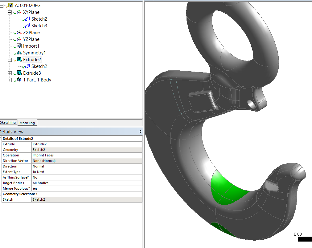

If you have design modeler license, for me simplest way is extrude a sketch with option imprint faces. So this command creates Patches.Cattura.PNG
