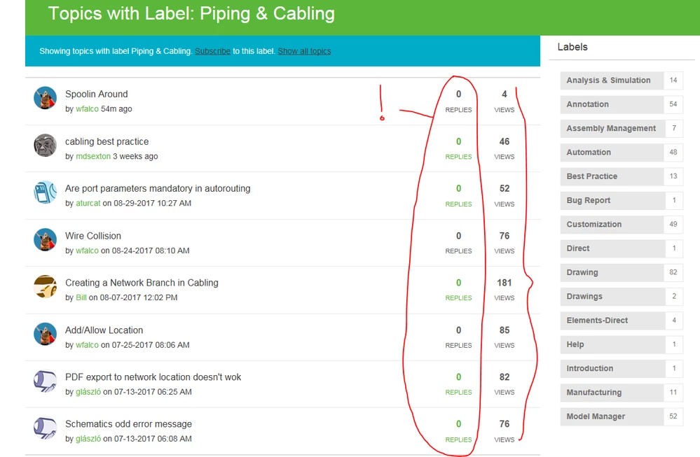

First off......is anybody looking at cable posts? I know one person.
Would sure be nice to hook up with some cable gurus.

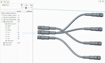

I have a main assembly (A).
I have a component assembly (B).
within "A" that has a harness (C).
I created a spool in A. The harness is in B. I want to remove spool from A, create a new spool in B and have it report to that. But....it's greyed out. If I delete spool from A, it reverts to some default spool-less state. So it lacks a spool. If I try to assign it via redefine...greyed out!

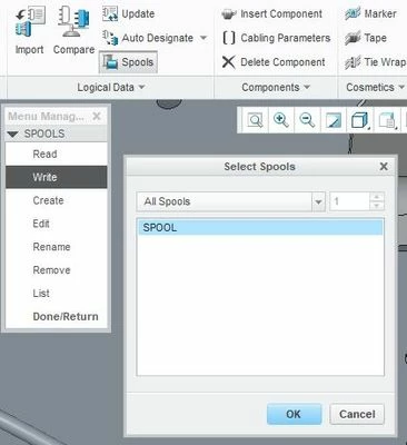

  2. Under "Logical Data" group - go to "Spools". Then in the popup menu that shows up, select "Write". Select the desired spool, and write it to a file.2-write_spool.JPG

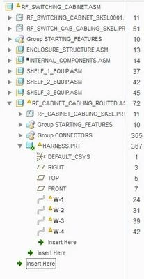

  3. Delete the spool from "A.asm". If you are using Creo 3 or 4, you should see the cable now has a yellow flag next to it.3-cables_are_broken.JPG

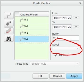

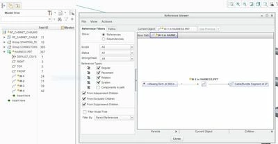

  5. At this point, again, you'll notice there isn't much you can do to the actual cable. the reference viewer will show the cable has a broken reference. Similarly, if you try to "Route Cables", then select the cable, you'll find that the "SPOOL" part of the window is grayed out.... but have no fear... there is still something you can do 🙂5-reference_viewer_shows_broken.JPG5-route_cables_shows_disabled.JPG

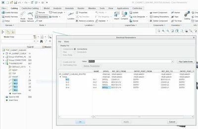

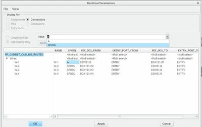

  6. Under the "Route" group - select "Parameters". Highlight the cables that you want to fix the spool for.

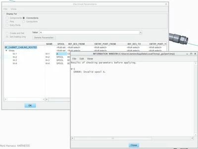

  7. A window will appear, and one of the columns will be "SPOOL". You'll see the name is still showing. Simply change the value for all the cables to ANYTHING else (like... "A"). Hit Apply. You'll see a window saying it isn't a valid spool. Then, in the "VALUE" dropdown up top, simply select the value for the spool you actually DID want to use, and hit "Apply".6-fix-spool.JPG7-fix-spool-add_random_name.JPG
  8. You'll see the yellow triangle disappear from the cable, and the cable will now be associated to the new spool that we created in the sub assembly. 7-fix-spool-fix_name.JPG

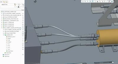

  9. Regenerate your model... and you'll see the cables all should look fine again :smileyhappy8-all_good.JPG
