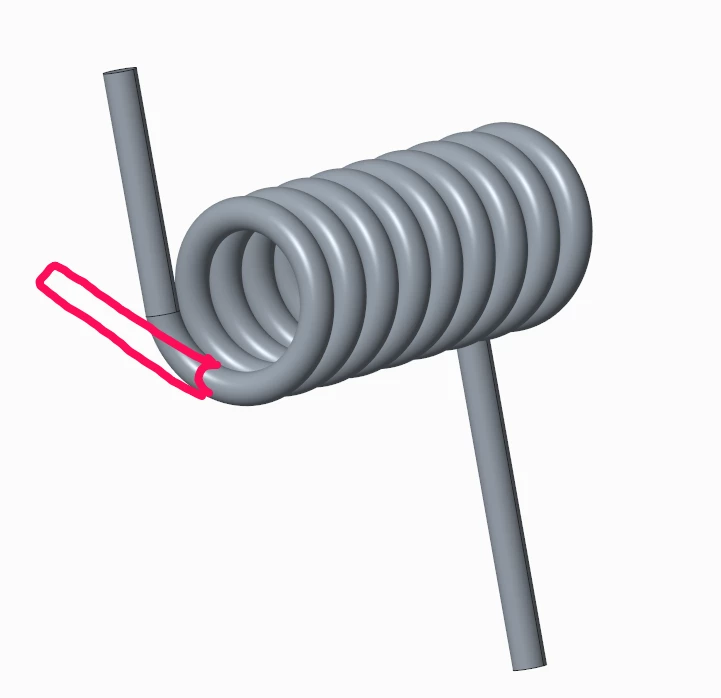

I have a question about how to modify the spring to achieve this:

cut a piece of helical geometry before you add straight end.

There is no info on how the model is built.  Is it a creo file, or a import feature?  Do you want to actually lessen the amount of coils fractionally, or just hack it off and kludge it as shown?  Are the ends tangent to the helix of the coil, or are they normal to the axis of the spring?  Is the (circular?) cross section normal to the trajectory/helix (the correct way) or normal to the spring axis (distorted ellipse).

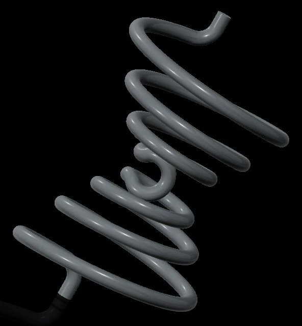

...aaaand for fun there's this (took me maybe 10min).

At this stage, my answer is: I don't know.
I was thinking about using points and its coordinates to create the spring but I don't know if this concept is right.

For what you're doing, which looks simple with the straight ends tangent to the ends of the trajectory, the curve by equation you mentioned would work better than a helical sweep because you can easily specify the start and end angle.
If you're thinking of doing it by a helical series of points referenced from a CS, don't, you won't get a nice cylindrical profile.
