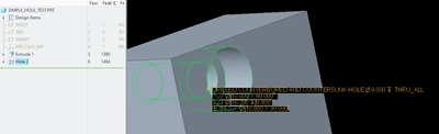

Apr 1, 2025 12:50 AM UTC
Hmm, I'm not sure what's going on for you and I can't replicate your error.
Here are my config.pro settings related to holes:
hole_parameter_file_path C:\my_holes
always_holetable_for_std_csink yes
hole_diameter_override yes
hole_file_resolution replace_with_external
This simple_drilled.hol file was made by copying from the Creo 10.0.5.0\Common Files\text\hole to c:\my_holes and modifying:
And seems to work fine on my system:
