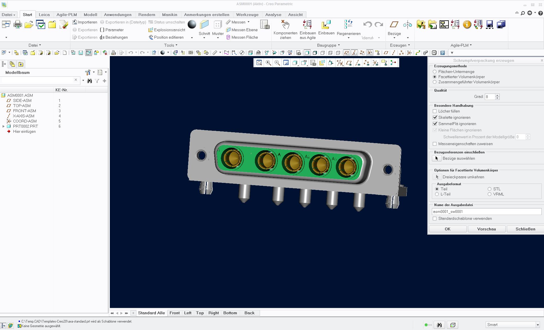

how do I repair the 3D Step Model ?
when I try to shrinkwrap the model , i see a message : No Geomentry selected.
I have attached the screenshots , may be it would help in understanding my problem .
February 9, 2016
model repair procedure is individual. please upload STEP file. Use How to attach file when you Reply to a discussion. procedure.
