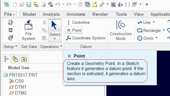

I am using WF 5.0 and the sketch datum point option is gone. What is it's replacement or where is it hidden?

It's been consoldated into the standard sketch tool. Start a standard sketch and look for the "geometry point" icon.

Thanks for the tips. I am not looking to add points to a sketch- I am looking to add a datum point by sketching. All the points in the sketcher do not show in the model as a point that I can reference. I have had some luck with using the datum point tool but it isn't as user friendly as the older sketching option.

Matt, you're missing it. Adding geometry datum points to a sketch IS the equivalent to the old sketched datum point feature. The only thing you need in the sketch is a one (or more) geometry points (and dimensions). You don't need any curves, lines, etc.

I am adding a geometry point to my sketch but it doesn't become a point. It becomes an axis. No points show. I am going to stop trying to find a solution. I have found a way to work around it. Thanks to everyone for your help.

A geometry point, when the sketch is extuded, will become an axis. If used in a stand alone sketch, you get a point.

In Creo 2 at least, there is a notice about extrudes creating axes... Probably because others have found what you found. But who reads the little pop-ups anyway
