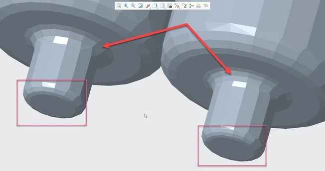

Would you mind drawing a simple picture to show what you are describing?when value is 0、0.5 、1
I want to know the physical meaning of it. If it is too trouble, can you post the reference link or other reference papers, journals, etc. that you recommend?

I think attached picture will help (Left is for 0.5 and right one is 1 Angle control) OR you can create a part with round and export to STL with three different angle control values (with same Chord Height).
