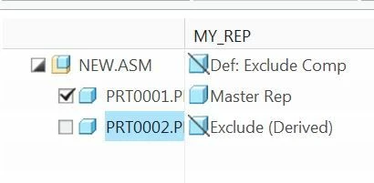

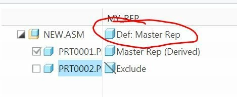

Two simplified Reps, exactly the same parts excluded and included as master, but defined two different ways.
Derived = use Def: (abbreviation for default)
THIS REP WILL PROMOTE SIMULATION ENTITIES UPWARD
THIS REP WILL NOT PROMOTE SIMULATION ENTITIES UPWARD

I don't know if this is something new in the functionality because I don't remember having this issue but I was able to re-create it.  I found that the DEF: EXCLUDE was the problem (in the sub-assembly REP) and changing to DEF: MASTER REP corrected the issue.  This way can be a little tedious if you have many excluded items but you can multi-select and right click to change the state.  This behavior is good to know because it is a way to control the propagation up to an assembly.
