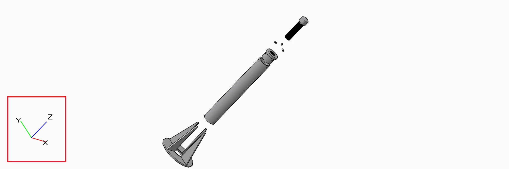

1> Is it possible to save any part/assembly to PNG or JPEG file format without the co-ordinates symbol highlightened as shown in the figure below.

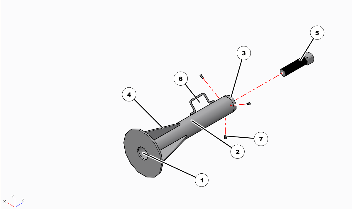

2> What modification needs to be done in Creo Illustrate Ver 2.0 so that when I am creating a Illustrated Parts List, the Leader line is generated from the surface of the Part and not from its center axis as shown in below figure.

In the below figure, one can notice that callouts 1 & 6 leader lines are genereated from the center axis of the part/component and not from their respective surfaces. How to resolve this issue?
Please note that the below figure is being exploded manually but the callouts where assigned using Automatic callout option.

Best answer by MartinHanak
I found information related to your question no.1.
To remove CSYS from window, do this:
File > Options
then select Global > Model
clear the check box for Display view gnomon
Apply > OK
