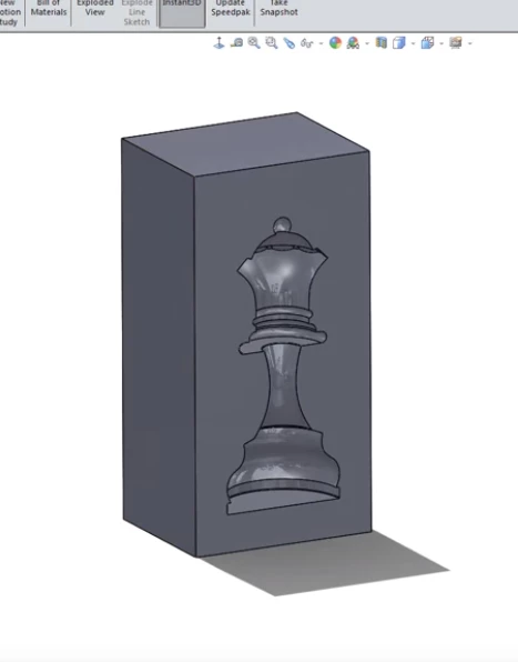

I am looking for help how to subtract a body part from another body part.
In SW it is called  Cavity.
Can anyone explain to me how to do it?
Arek

For solid bodies, you can use Merge/Inheritance. In the part, go to the model tab, then the Get Data drop down arrow, Merge/Inheritance.
Just like an extrude, toggle to remove material, then you push the Open folder icon, select the body you will use for the remove, and "assemble" the body in as you do in assembly mode.

Hi @StephenW
For clarification,
Should it be an Assembly or Multibody Part?
Arek
StephenW
StephenW23-Emerald IIIAnswer
November 29, 2018
Neither. The procedure I described above is in the part mode. Creo doesn't have multibody parts.
You can "merge/inherit" a part into another part, during that process you can specify if the merge part adds material or removes material.
There is a similar feature in assembly mode where you can "cut out" one part from another.
