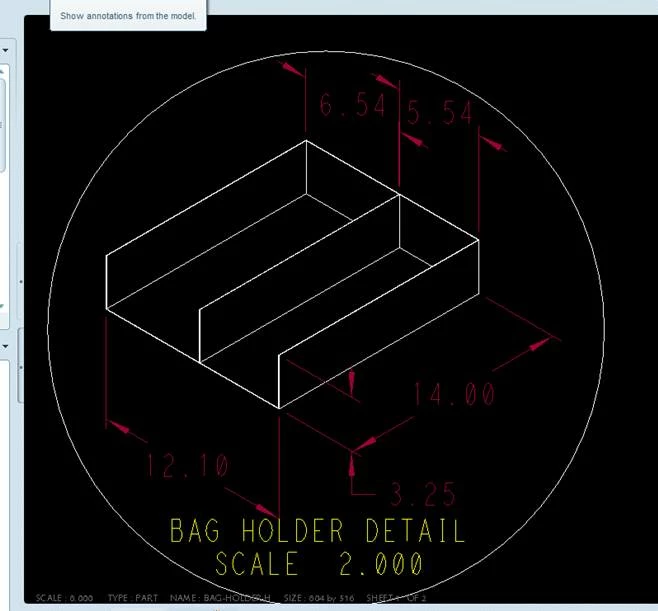

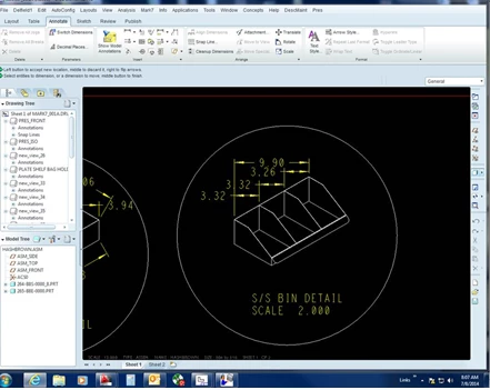

In your drawing setup file (File>Drawing Options) find the allow_3d_dimensions.
Default value is 'no.'
Well, one way of doing it is to create the annotation on the appropriate plane in the model:
