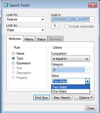

One suggestion was to find all of the one sided edges with Find. The Find
command does actually appear to do that, but it does not appear to work if
the object is imported. When I would select the import, I wouldn't get
anything, because Pro sees it as one entity is my guess.

But the best solution is the IDD, and then Geom Checks. I did remember
seeing this at a user group of conference, but had forgotten where it was.
It's buried fairly deep.

Darrin, while in IDD, select Info --> Geometry Checks. Once there select
Edit --> IDD Settings and choose the checkboxes of areas you wish to
highlight. You will then get a listing in the Import Feature that you can
expand and select to show in the graphics screen. There is an IDD
tutorial in the Help Center that has directions and models to provide some
familiarity with IDD. Here is a link to a video from a tips/tricks
session on using IDD:
