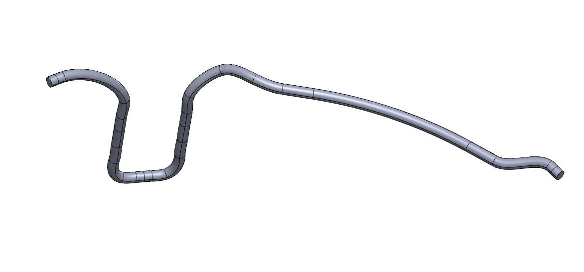

SUMMARY: measure the length of an IGES pipe-like part?
  • October 4, 2010
  • 8 replies
  • 3477 views
I received lots of helpful replies (I love those visuals). I will need
to try them when I have some time.
My objective:
1) To be able to recreate the part
2) To be able to measure the line (If there are time constraints)
Thank you all!
-Art
Note: sure would be nice to have some video tutorial ; )~

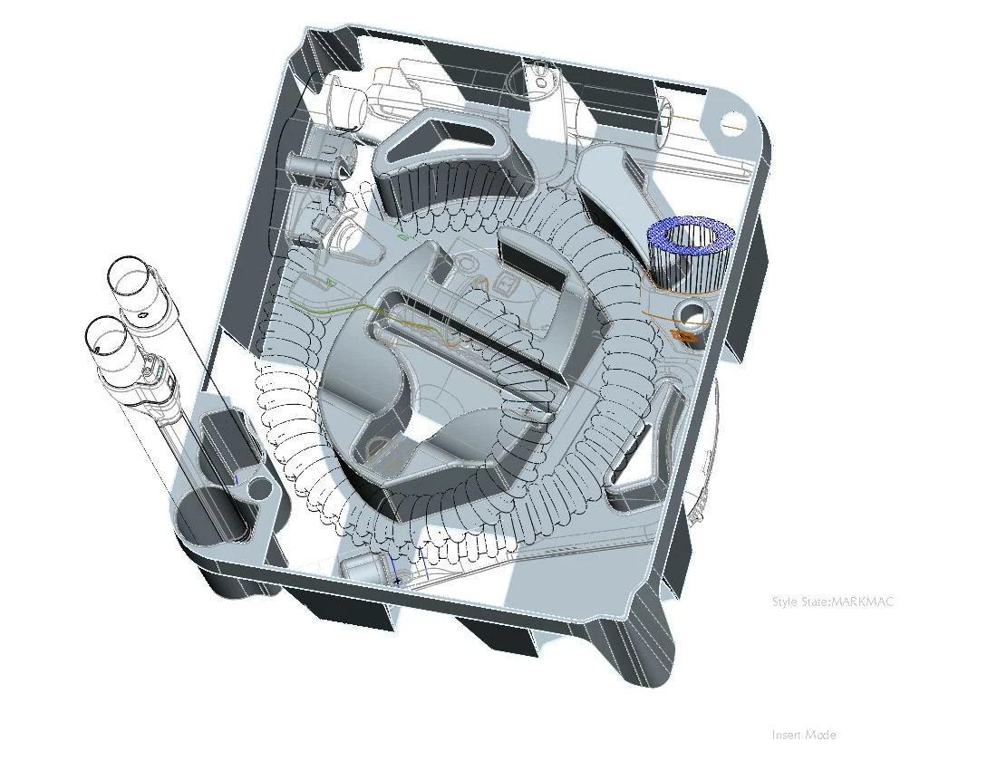

You guys are getting me there, but he wants the shaded part to be hidden
behind the components. See attached. TC

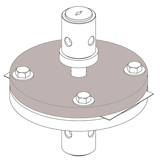

This should do it
Try this.
Bob Frindt
