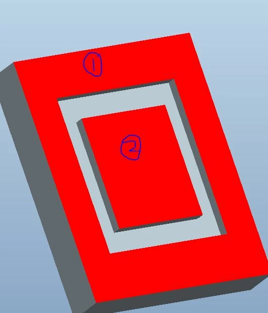

I've been using Pro/E for years; currently with Creo/WF5. Still couldn't find an easy way to make the same surface that are seperated by a cut, rib, groove, etc. to be different color. Basically, make surface 1 and 2 different color/texture to show how that area might be painted.
2 ways I've done are: both more time consuming than it should be.
  1. make a copy of the surface that is slightly offset and remove the unwanted surface.
  2. make a decal in Photoshop, or post process the image in Photoshop.
Anyone knows a way to leave out the surrounding surface that the color should not change similar to an option for copying surfaces?

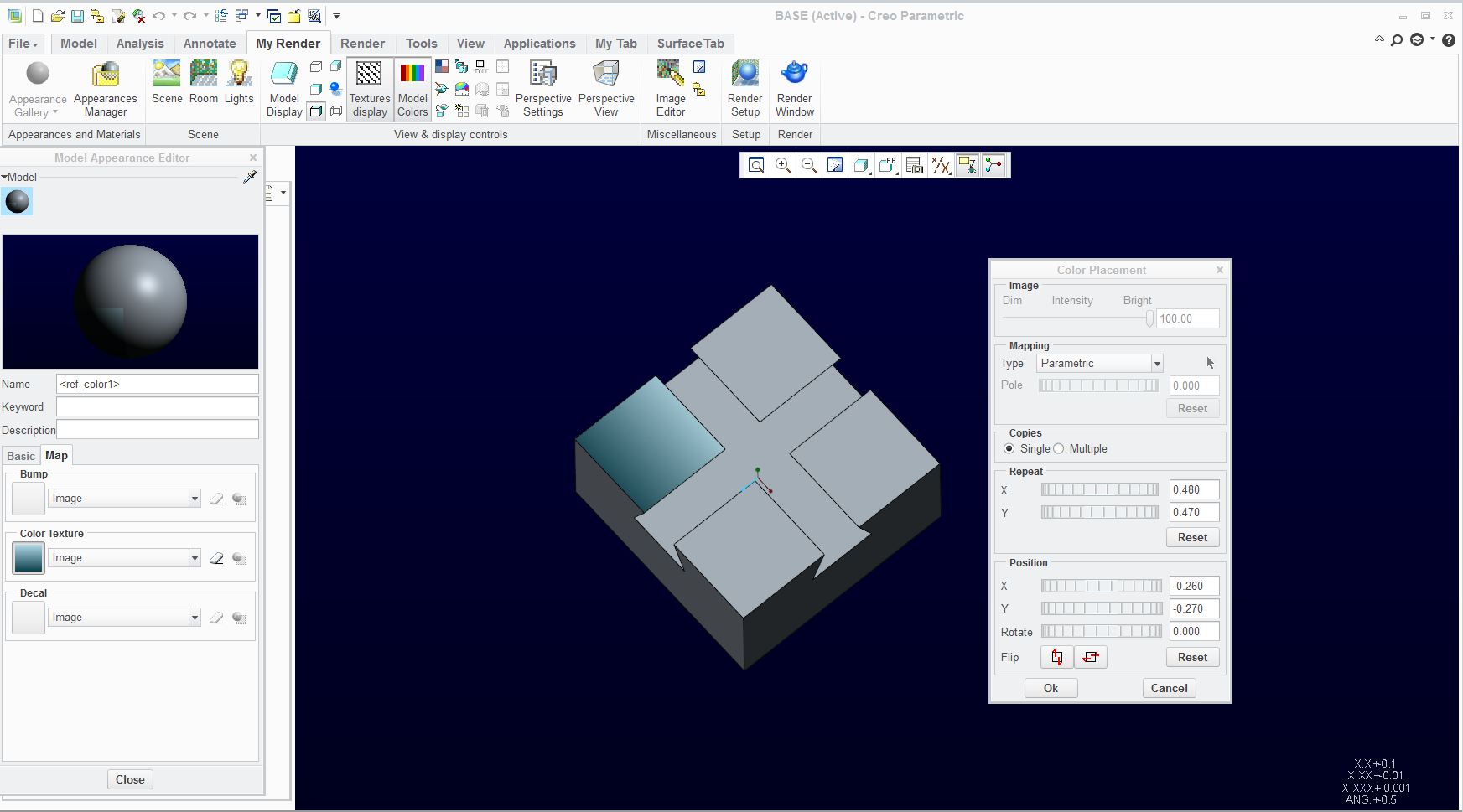

Your second process is probably the best to use. I say this only to maintain comprehensive geometry.
But I would keep the image simple and manipulate it in the appearance manager. In this case, you can apply a solid color texture to a smaller region by manipulating the texture once it is applied. You have to edit the Model Appearance and use the eye dropper to select the appearance you want to edit (cannot be default).
Here is the image from Creo 2.0 that lets you modify the application of the texture/decal/ whatever.
edit: remember to change the Copies to Single

I use the decal method for simple stuff like you've shown. However, it is difficult to do this if the surface becomes complicated. Let's say I want to color 2 sections in different color with a non-geometric cut thru them. Just to create a decal to folow the shape would be difficult enough, but trying to align that in Pro/e again is almost impossible. Additionally, the decal used has to be in the same directory for someone else to pull up the model to display the correct color.
All I want is to be able to isolate the selection when applying color. Maybe there is a config file? What about in Creo 2.0?

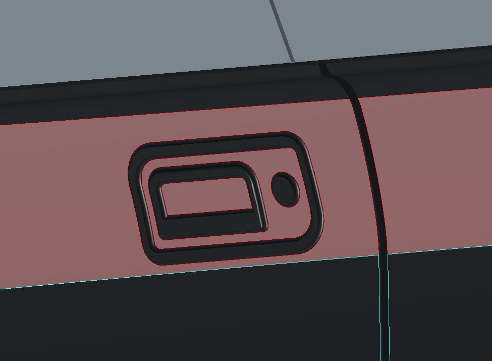

If you want to show milled surfaces of a cast part there is another way:
- give your part the color you want to see in the grooves
- give all surfaces your standard color **
- then create grooves, holes, cuts etc.
You should set a mark in model tree where you set the colors because adding material later on must be done before that mark.
