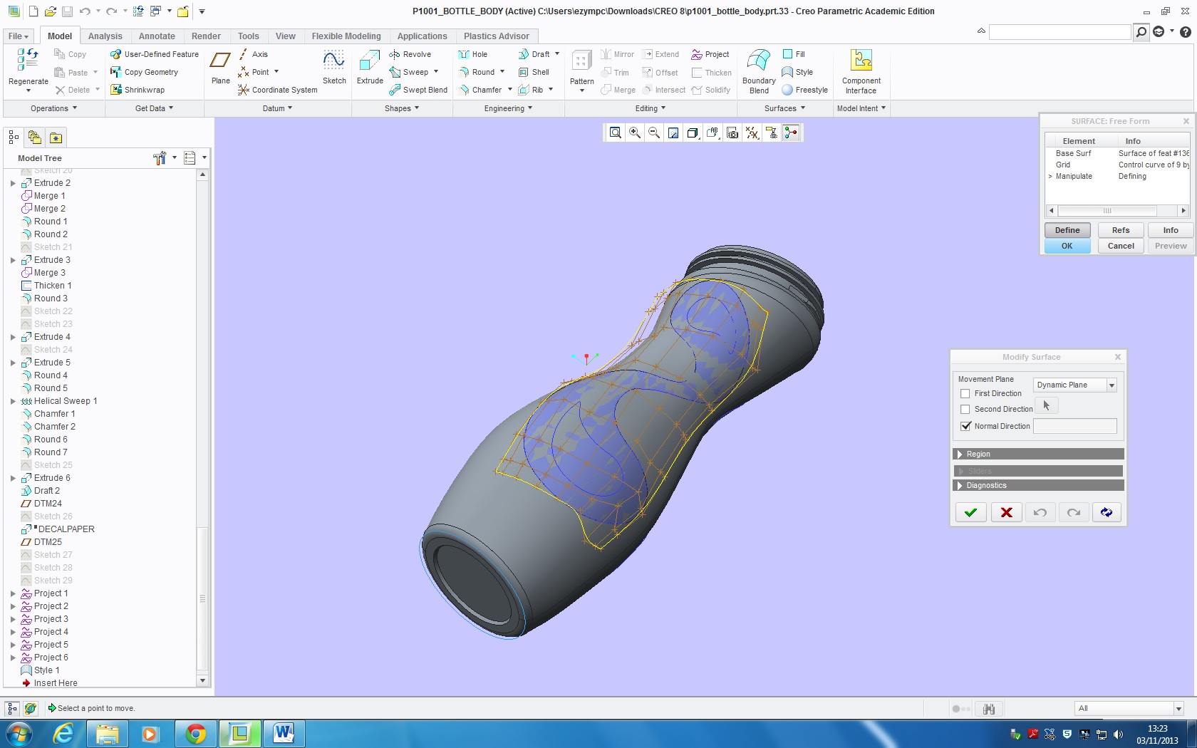

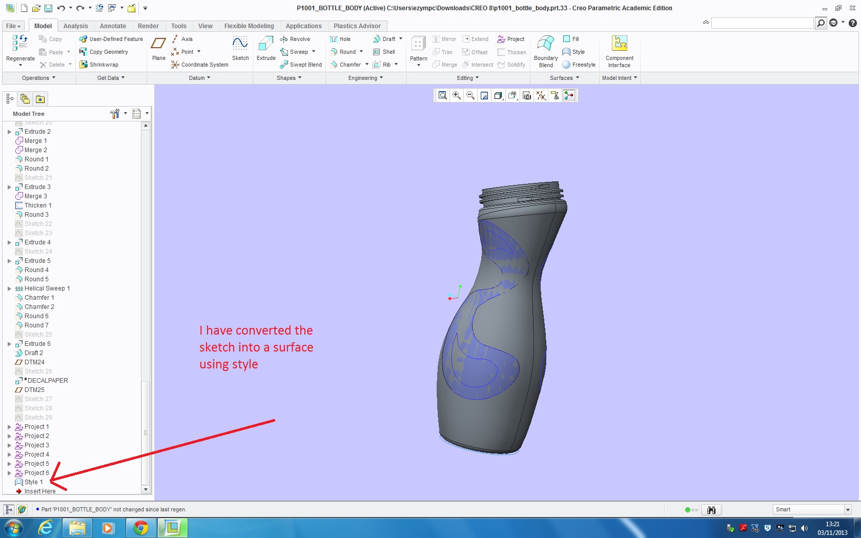

I'm having issues achieving what I need for a Creo Assignment.

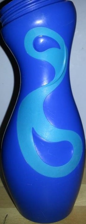

I am attempting to emboss some shapes on the curved surface of a drinks bottle I am modelling.
I've provided a photo to demonstrate the desired effect. (keep scrolling for creo screenshots)
My instinct was to use surface freeform, but it deforms a region far greater than the boundaries of the shape.
Any suggestions?

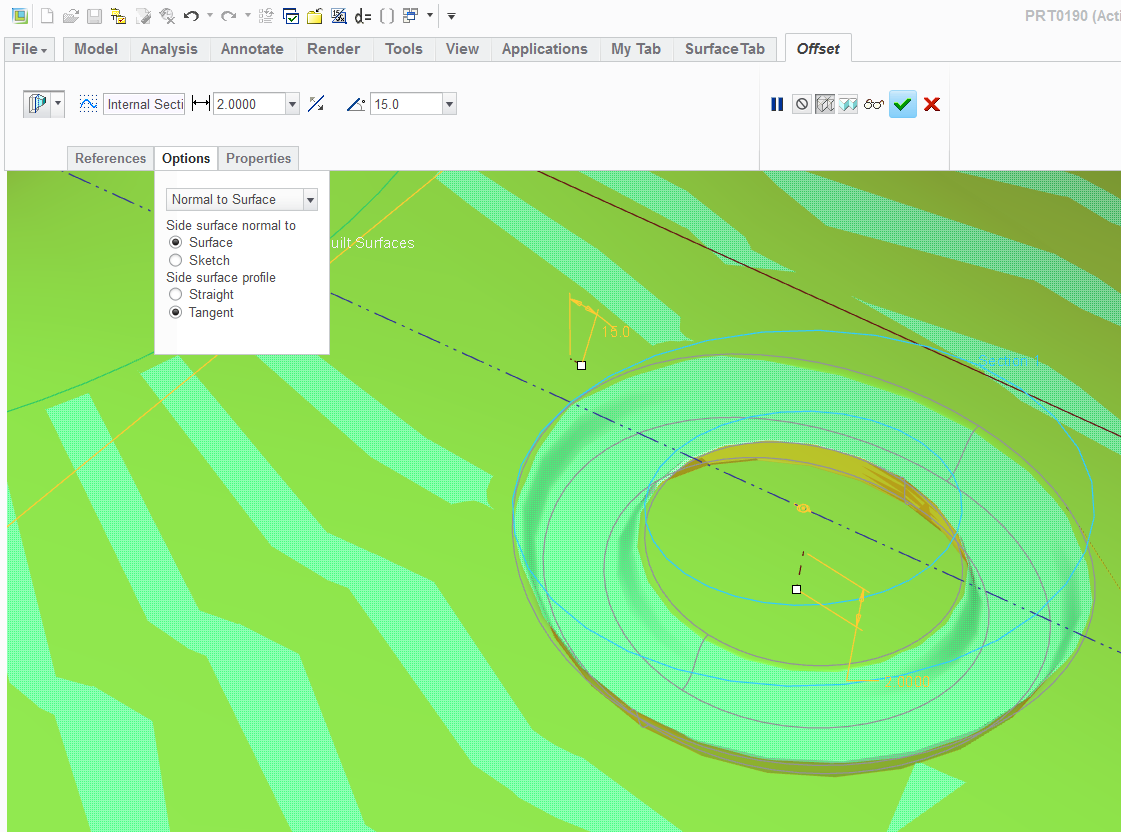

November 3, 2013
This is easy by using the offset feature. You want to choose the option shown below:
