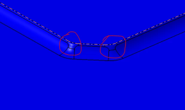

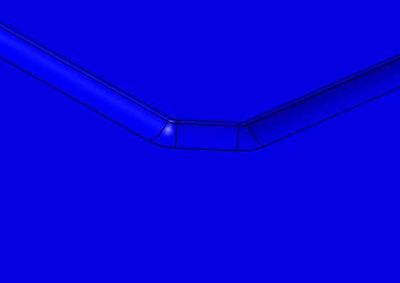

I've an imported surface, that I need to make some changes.
Initial stateInitial state
desired statedesired state

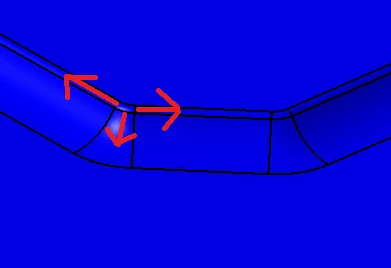

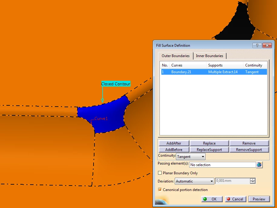

Generally in other CAD system (for example CATIA). I could do the follwing.
Make a copy of the edges, and them make a translation to them.Make a copy of the edges, and them make a translation to them.
Then, make a spline between the translated edges, and make a trimThen, make a spline between the translated edges, and make a trimfinally, wtih the fill surface command, I pick the border of the surface, make a tangencial constraint between the original surface, and the new one, and the surface is closedfinally, wtih the fill surface command, I pick the border of the surface, make a tangencial constraint between the original surface, and the new one, and the surface is closed
Now I need to replicate those steps in Creo, but I don't know how to do it. Remember, i'm working with imported stp files, all the surfaces are dead.

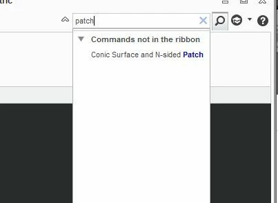

Where I can find the n-sided
September 18, 2018
The "N Sided Patch" command is not in the ribbon, at least in Creo 2, you need to search for it using the command search.
You also may need to set the config option " allow_anatomic_features"  to yes.

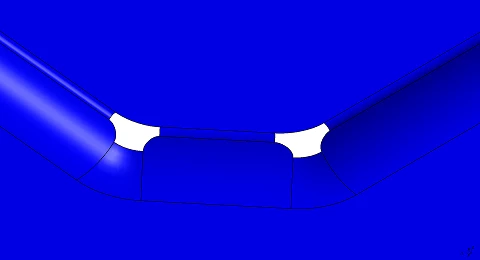

I was able to create it without using style, I've attached my Creo 2 model.  I also found that trying to create the patch in one step resulted in unwanted wrinkles. I created half, mirrored it, merged and then solidified.
