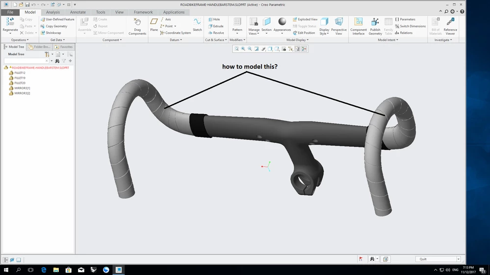

201711120715.pngI got a model. I want to know some features how to model it. it looks like a bit difficult and it is a bigger challenge for me. is anyone can help me and give me some advice to finish it?

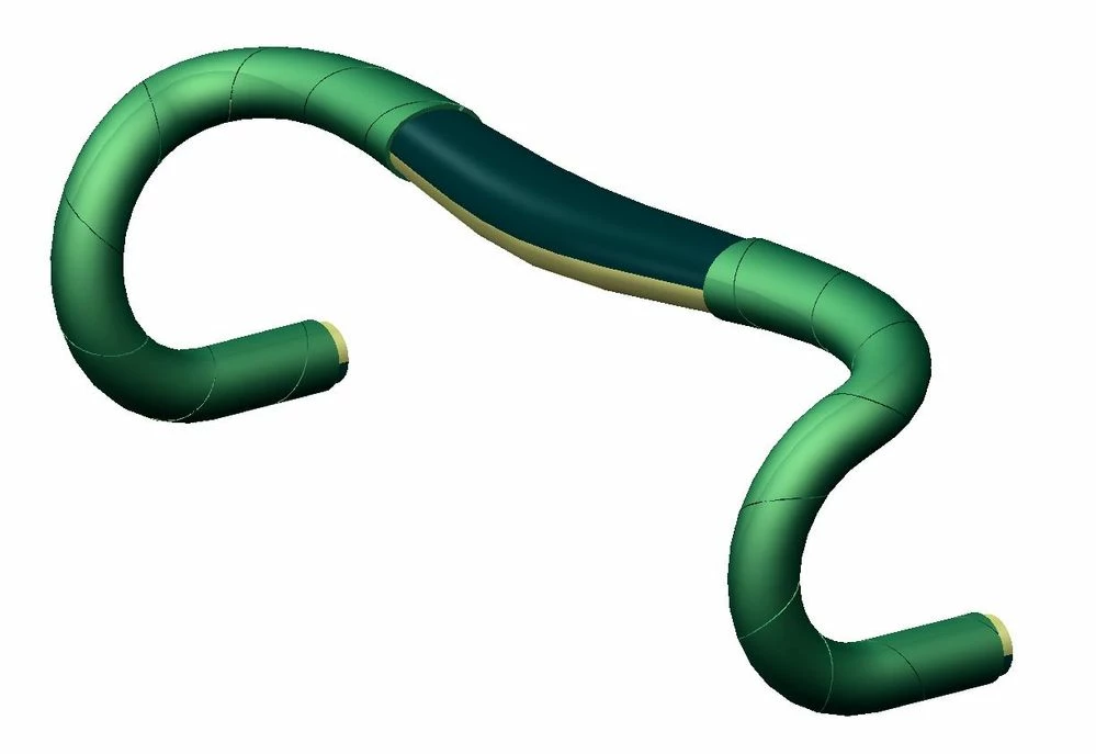

This is what I have come out with:Capture.JPG

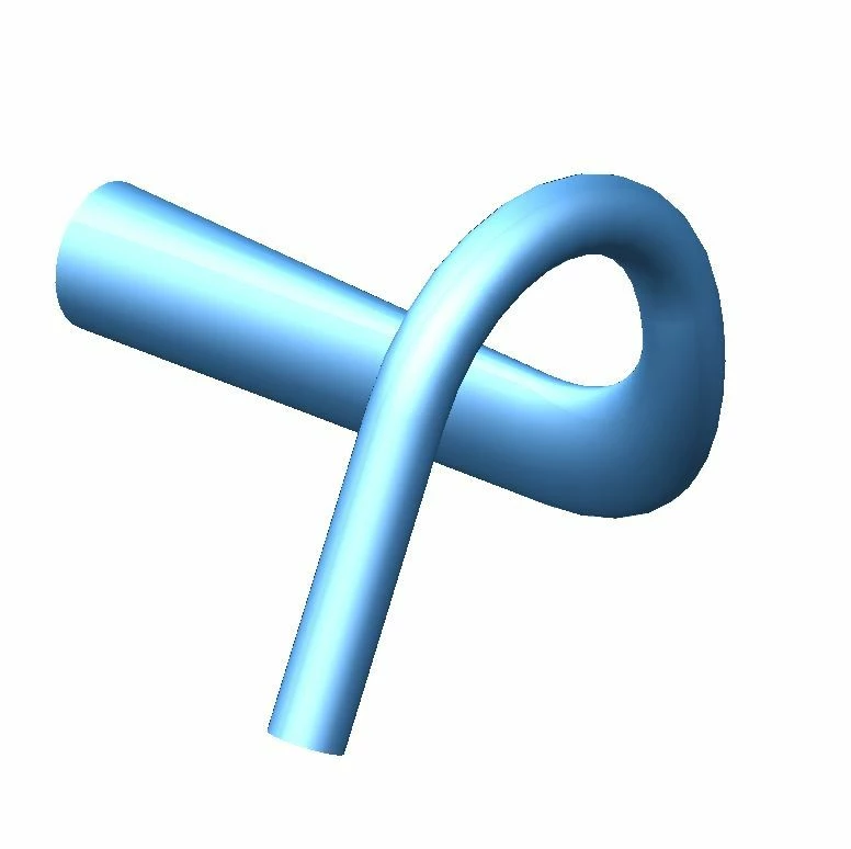

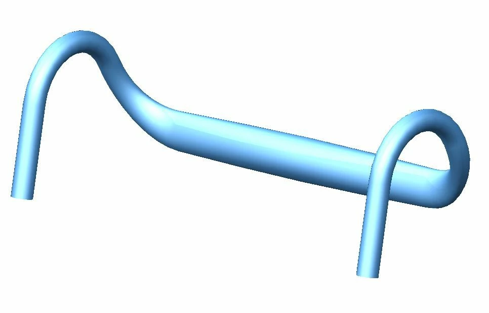

This is done using a single swept blend command:Capture.JPG

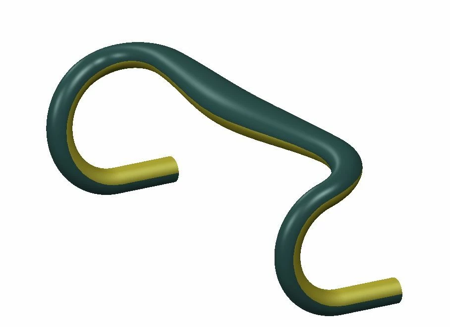

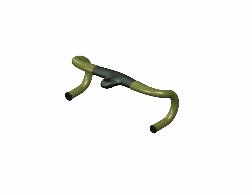

I guess that OP wants to know how to model fabric bandage covering handlebar.
