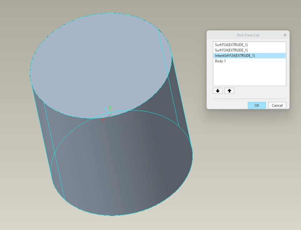

Hi Created cylinder in creo by using extrude, I need to use this surface in optical analysis, But when i click surface, just half of them selecting, for the other one we need to select with CTRL, But this is no good my optical simulation, Simulation software requires me just 1 clicking ,
How can built this part as a on single surface,

If it has to be one surface, .... you will need to use another software.
Creo always makes cylinders out of (2) surfaces.

@Dale_Rosema was correct with his response. Creo always splits cylinders in the geometry kernel.

Yes but it  should be a single surface in Creo, Unless it is single surface, My optical software does not recognize it.

Creo always splits a circle.  If you can get by with an almost complete cylinder, you could use two arcs to make the extrusion, one 359.5° and the other 0.5°, creating a sliver for the second surface.
Apr 24, 2023 1:01 PM UTC
what if you create Revolve surface feature with angle 359.9 degrees angle which has the same diameter as solid geometry and select this surface feature as reference for simulation.
