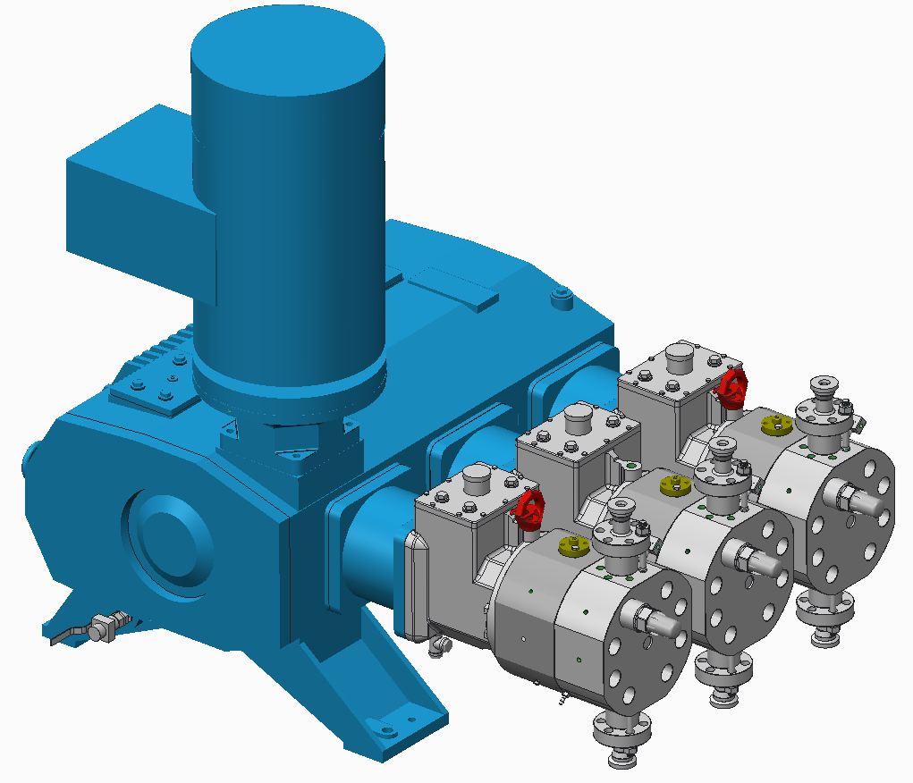

Hi all,
We get imported data (iges/STEP) of components which we insert into larger assemblies. These models generally upon import become surface models.
My problems begin when I have to start creating drawings, views take a lot longer to be generated and regenerated.
It becomes hugely frustrating.
has anyone else encountered this?? I have worked on several different pc's running various versions of proe and the problem seems to persist! Have I got something in my config that is causing this, or is there something I can add to stop it!!!!
Any help at all would be fantastic

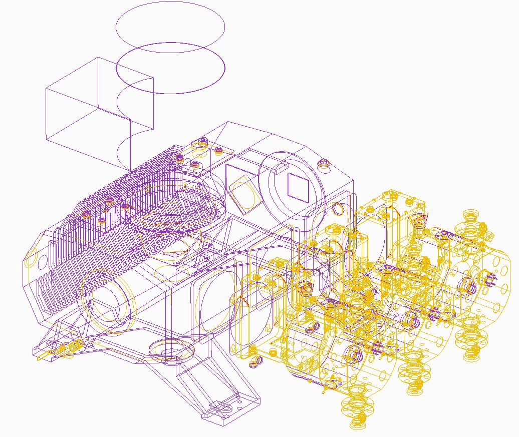

June 14, 2013
Hi Michael,
I have included a couple a screengrabs to show the issue, the second image shows how many open surfaces are in the model. (this is the largest - igs size 13Mb)
If you like I can send one on for you to look at? (will require some kind of contact detail)
Cheers
Paul

June 14, 2013
Hi Paul,
The key is to import them as solids instead of surfaces. But importing these kind of large assemblies as solids gives missing information, small surfaces get ignored.
I had this issue also in the past and could solve it by using an external IGES/STEP convertor and then import the new file. This improved the amount of holes and missing surfaces a lot.
Another solution that you can try is making a shrinkwrap of the received product, there is a chance that PRO/E can close the gaps for you.
cheers,
Alain
June 14, 2013
Gents,
Thanks for your responses.
Please note the image above is importing as one part, no sub assemblies.
Im presently trying to get the supplier to export as solids, but it seems to be falling on deaf ears
So are there any settings I can use when detailing as this is my main problem??
June 14, 2013
Turn down your graphics quality in options. I have noticed that this -really- dogs the application in drawings. No line smoothing, low graphics quality... etc. You can also turn off colors and textures if they're used.
