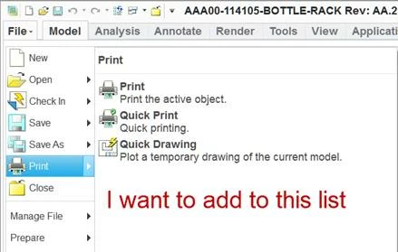

This is something I've been complaining to PTC about since the beta release of Creo. I seem to be getting nowhere with this complaint, so I thought I'd ask the community if this is something you want.
Creo, doesn't let you add commands to the file menu. I want the ability to add mode independent commands to the file menu. One example is adding to the File, Print menu. But I would like to add to the File, New menu also.
[cid:image001.jpg@01CD0841.8A0D0D20]
Is this something you would like to do?
