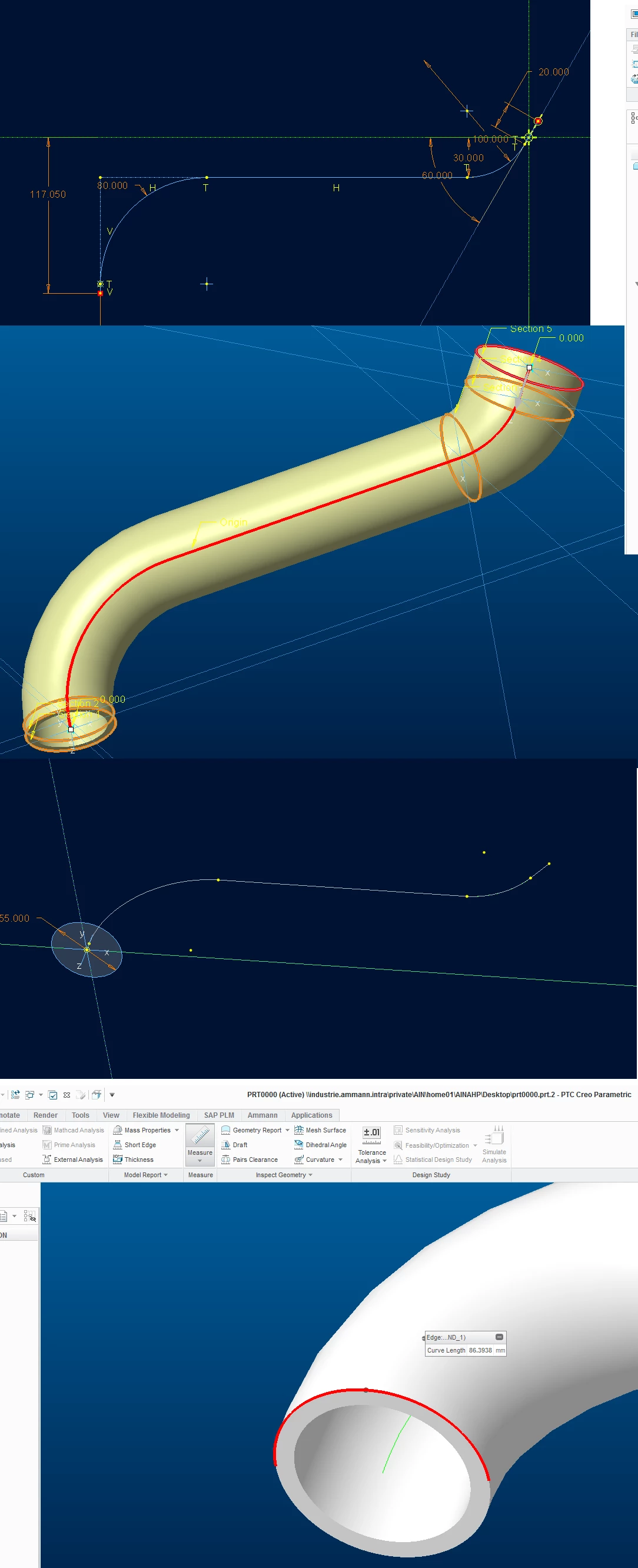

I made part using Sweptblend command. Trajectory at both end is straight & all sections are round. As attached image When I measure Diameter at the end it does not shows. Instead of it Arc length showing. Also It cant assemble in assembly by coincident constrain. So I have to made it by Sweep & Swept Blend command with using Three or Four command.
So What is way to do it by Swept-Blend.
Thanks.
September 4, 2015
it looks like Creo does not recognize begin/end part of your geometry as a cylinder. That is all. If you need more information, please contact PTC Support.
