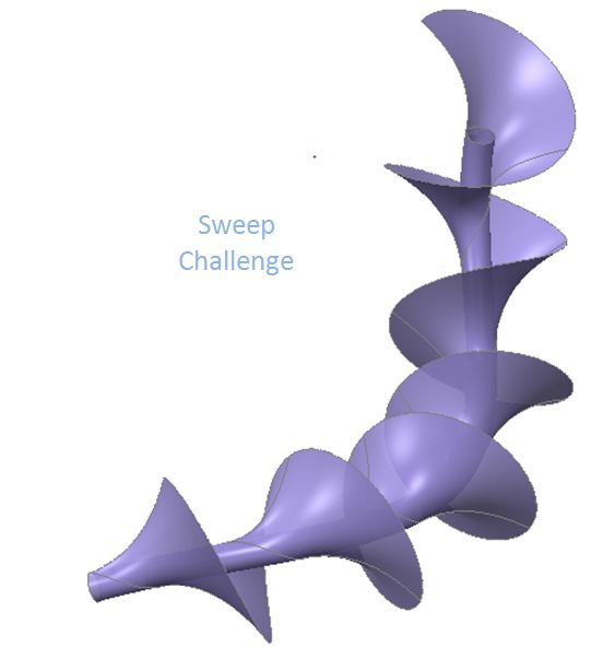

Hi, I have been trying to model the geometry shown below using sweep. I managed to model its trajectory but not the final shape. I attached the stp file here for those who would like to give it a try. Appreciate you can share your technique to obtain the final shape. ThanksCapture.JPG
Best answer by TomD.inPDX
This is where I have to leave you to scratch your head a little and explore the existing model...
hint: It is as simple as changing the sweep3 section, which is already tangent, by removing the line segment; then using the appropriate edge to sweep the right size cylinder through the part along the edge of sweep1.

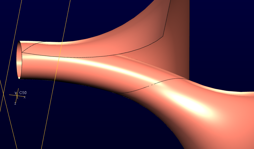

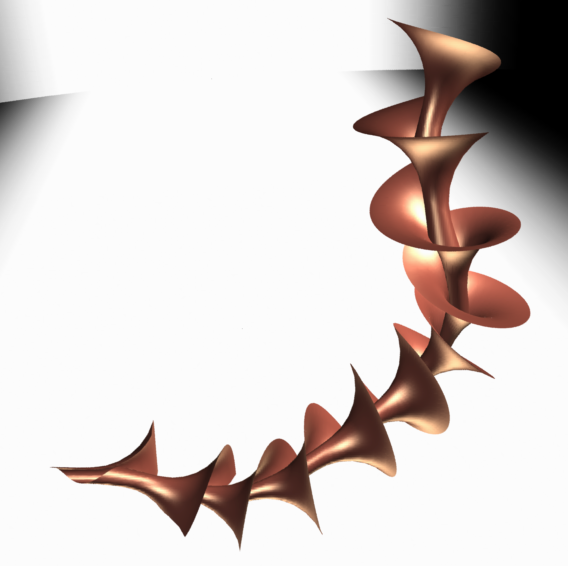

Without digging into it too far, I am going to suggest that the 1st sweep is done with a VSS for a subtle spiral around a simple elbow.
The 2nd sweep is an arc profile about the edge of the 1st sweep.
edit... okay, 3 sweeps.  Yours has a cylindrical core which I didn't add, but the final sweep uses the 2 previous sweeps
This failed miserably when using a simple line/arc/line sketch.  I switched the original spine to a spline and it worked wonders.
Creo 2.0 commercial file attached

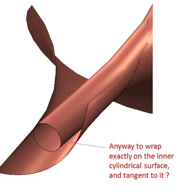

Being more ambitious now,  I want to ensure the inner edge of the final swept surface lands exactly on the inner cylindrical surface, and tangent to it.(refer to the earlier step model) What should I change to achieve that ?
October 25, 2015
