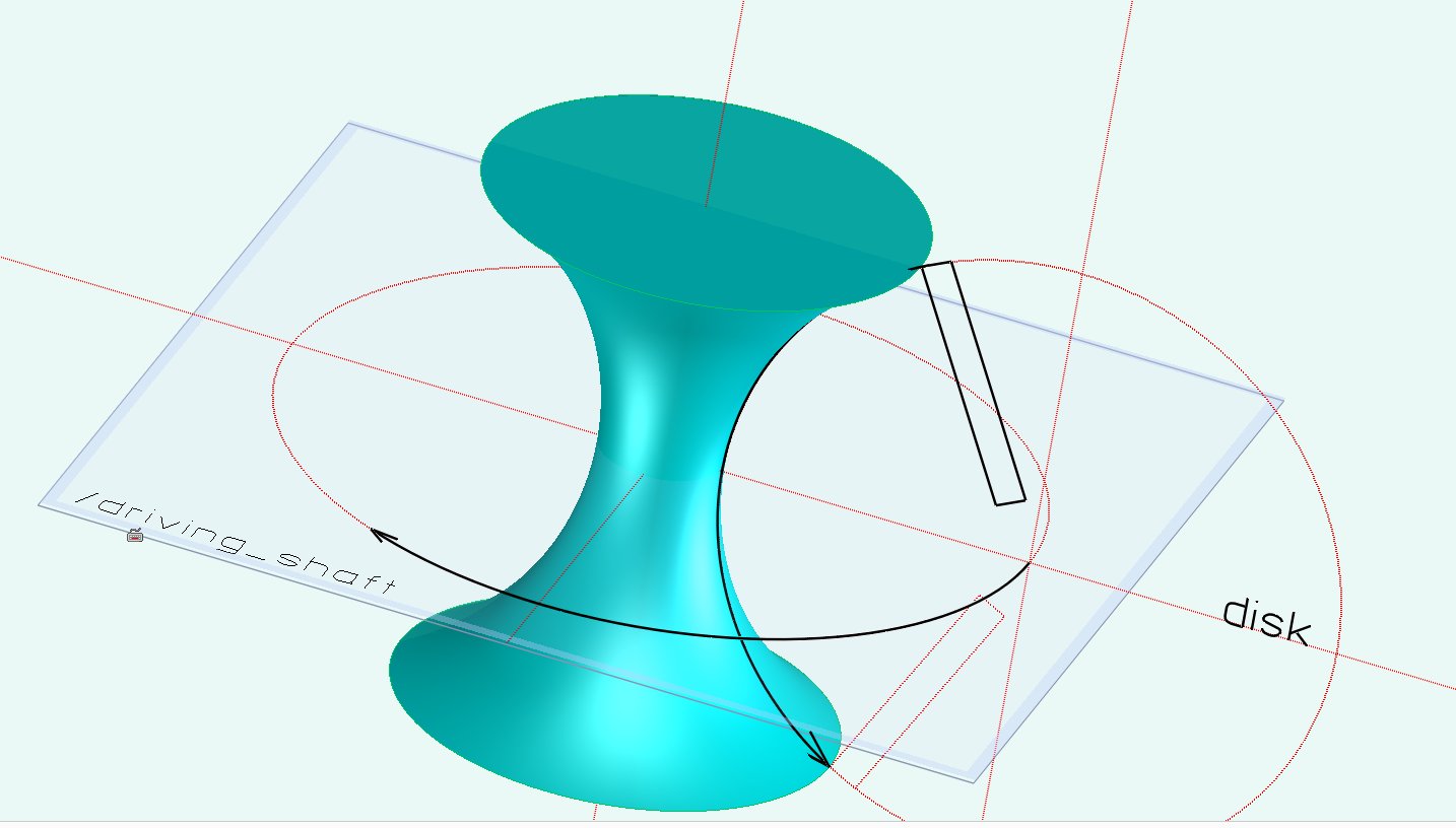

Dear All,
please have a lokk on the following drawing:
I would like add material to the driving shaft by sweeping the rectangular profile on the disk simultaneously around two axis as indicated in the drawing. I. e. I would like to rotate the circular disk around its own center point while at the same time rotating the entire disk around the main axis of the driving shaft.

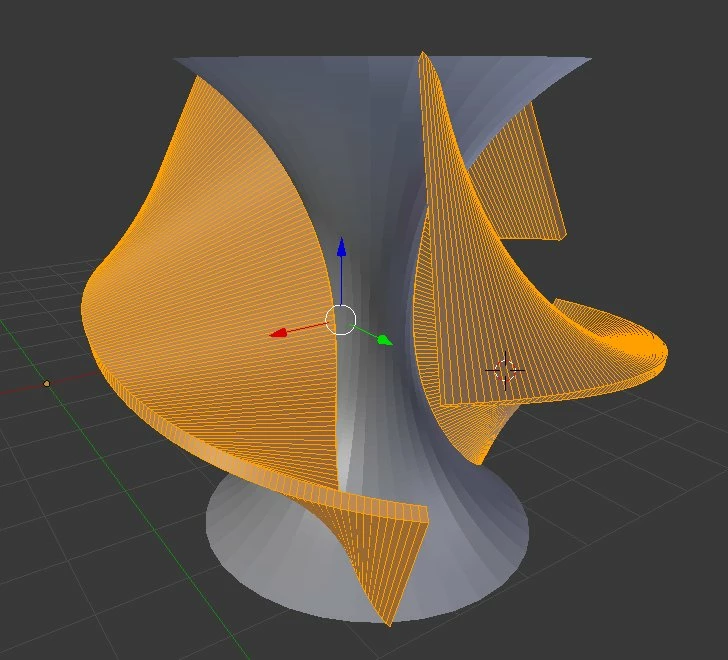

Beside of the oposite orientation of the propeller wings, which have been multiplied three times in this quickly scripted Blender model), the result should look like this:
Does anybody have a solution how to generate the complex geometry of this(these) wing(s) in Creo Direct Modelling Express 6.0? I would really appreciate to create this pure technical model in Creo rather to switch to a non-CAD system like Blender (which I love for other purposes, but not for precise CAD modelling ).
