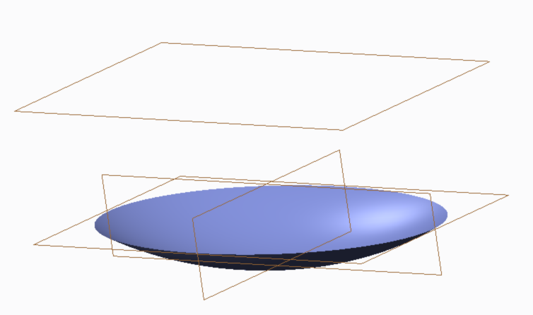

I would like to sweep a solid along and ellipse so it looks like a spoon shape (no handle). How can this be done? I've use var traj sweep. Will sweep but results undesirable.

Without seeing what you're trying to do, try a regular solid sweep with "Add Inner Faces".  If not, you'll probably need to do a Boundary Blend.

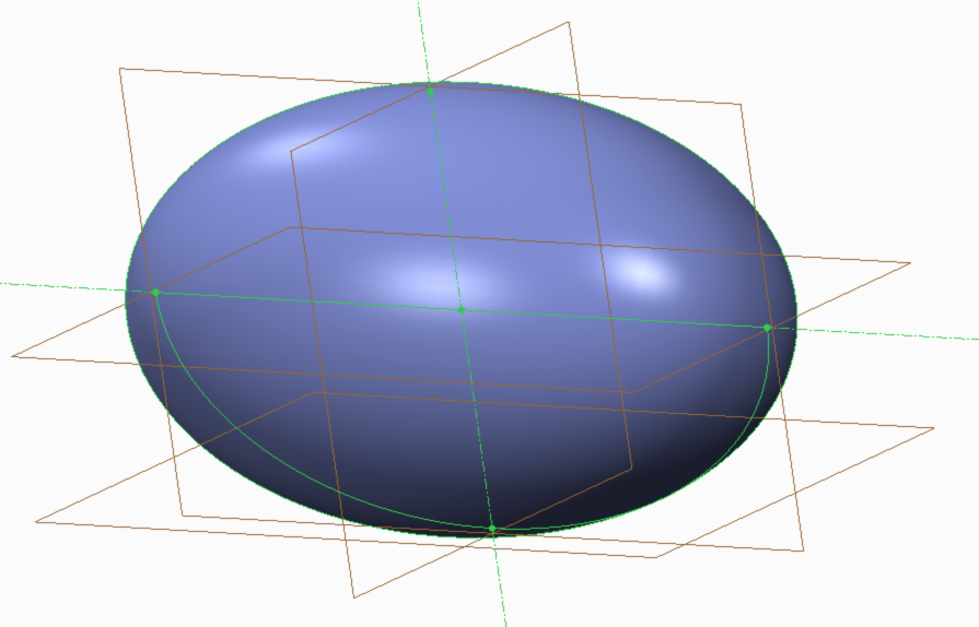

Need a little more info.  You say "sweep a solid", do you mean sweep a cross-section into a solid because Creo/Pro doesn't have a drag solid capability except for creating tessellated envelopes, which won't create smooth geometry.
As for a spoon shape, Var traj sweeps can do a lot, but the best way is to revolve an ellipse into a paraboloid (egg shape) and then cut away a portion.
If this isn't what you want, post a sketch of what you're looking for and I'm sure someone will give it a try.

An option using a boundary blend would be as follows (I don't have WF4 installed anymore, or I'd post a model for you):
  1. Sketch an ellipse
  2. Create a datum plane offset from the ellipse sketch the height that you'd like the "spoon" shape to be.
  3. Create a datum point on that plane at the center of the ellipse.
  4. Create a boundary blend using the sketched ellipse and the point as the two curves.
  5. Create a tangency condition at the datum point to the offset plane.
This should create a nice domed surface which you can use to build your solid.

Your solution is basically the idea. Thanks!
October 5, 2015
Yep, that's it.  I did see it after posting my response here.

Actually - what Antonius did online is my start part. He just tweaked it. That is same result that I have.
