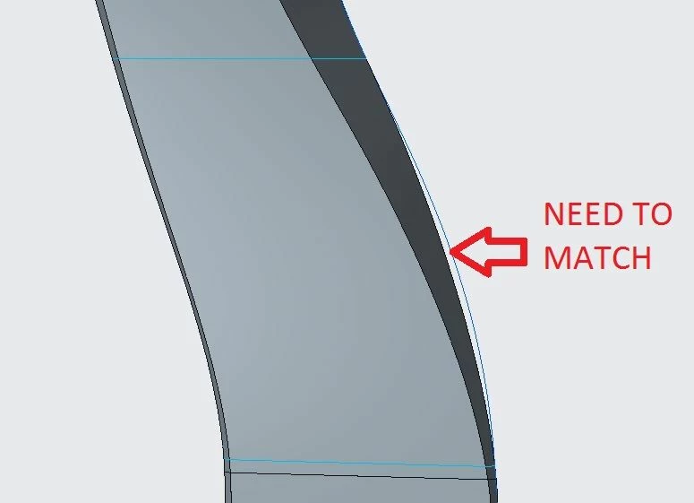

I need to build a progressive model based off of customer geometry which was built in Catia.  The only issue I have is in matching their loft feature.
Because of the shading you can't see that the customer driven left curve at the parting intersection falls inside of the loft so it doesn't match up as well.
I can get 1 side to match up correctly by using it as a reference curve, but the other side will never hold position using this reference.
There is the option to add a secondary reference (or trajectory) but this reference never holds tight to the curve.  Ultimately I really would like the secondary reference to be meaningful by laying directly on the needed curve.
I have made a curve based off the centroid of all of the sections but this throws both sides out.
The depth  is off as well as the sides.
I've looked at every option but couldn't find a way to influence the results to match sides and depth.
Perhaps I will need to make this a boundary blend feature, but it really should be possible to match all sides with the Swept Blend.
Before I give up would anyone know the trick to getting a good Swept Blend?

Without model no one can help you, but i'd say to you to try to add more trajectories as referenses and this way shape would be more controled/precise.
pimm15-MoonstoneAuthor
October 20, 2017
Unfortunately due to customer propriety I can't provide a model.
With Swept Blend I believe you can only have a primary and secondary trajectory.  If my primary trajectory lies on 1 of the needed curves, unfortunately the secondary will not pull out to match the opposing curve.
In our old software there was a feature called Bi-rail Loft.  That is kind of what I would like to use, but within Swept Blend the secondary reference appears to be of little value.

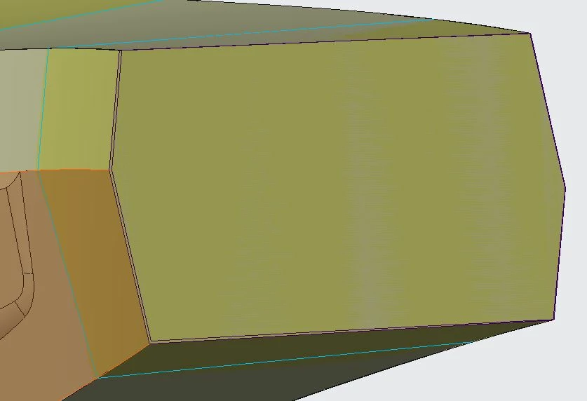

October 24, 2017
By adding extra sections it has stabilized the Swept Blend somewhat.
I still however am seeing variations in between sections that could cause issues in manufacture.
On the left side of the attached picture you can see how this is falling out compared to the original.
I could continue adding sections but at some point I'm thinking that the result will become bumpy.
If it isn't possible to control the result with holding the parting line rails at least it would be nice to influence some directional pull from section edges.

Can I ask, if you have a model already, why do you have to duplicate it?
October 25, 2017
Inoram:
Sure, the reason we need to do this is that we need a size for size template and from that template we need to add draft and radii for different pre-forming impressions.
A pre-forming impression needs to fall inside the next impression, the following impression and finally the customer model impression.  That is why I need to start with a very close representation of the customer model.
