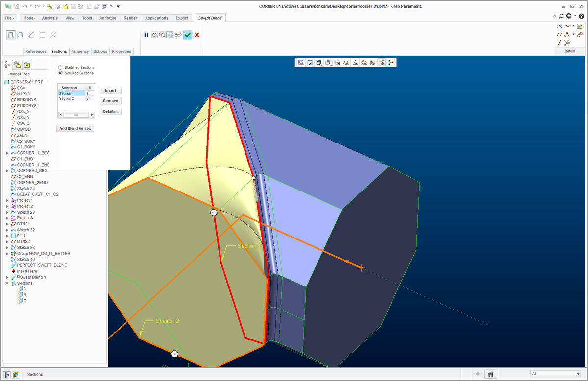

l have a problem with swept blend feature. Can´t put right "control points" together and results swept blend is rotated.
What i have tryed:
- hangling white points around all vertexes
- rotate sketches
- redefine secondary sketching plane (know sometimes it makes similar rotating with boundary blend feater)
- define swept blend X-direction (just tryed my luck --- not familiar with this)
Part file should be attached.
First question:
Could you explain me what is wrong with second swept blend feater?
Second question:
Do you have any idea how to do middle part better way? Just in 1 feater without merge?
Best answer by mbonka
Due cooperate with czech technical support from Aveng l discovered, that problem is in model accuracy. Change to bigger value repaired failed swept blend feater.
