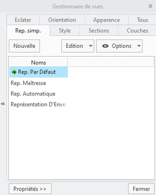

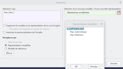

I tried it in Creo 8.0.4.0 and saw that the "Default Rep" was not available in my drawings (example pics 1 / 2) whereas any other representation that I created were accessible.
Picture 1 : View manager from my ASM file "A_SUPPV4854.asm"
Picture 2 : From my DRW file "A_SUPPV4854.drw"
Is there any other way of selecting it without redoing BOM Balloons ?
