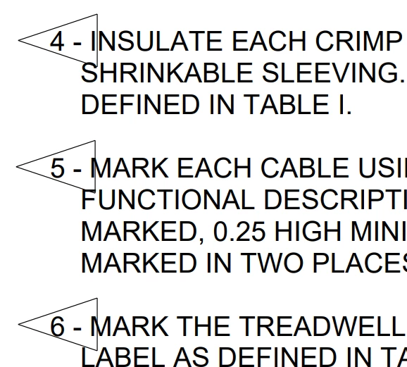

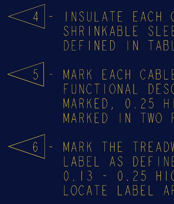

my client has a symbol defined that is a triangle (lay it down sideways so it points to the left) with a number imbedded.  It is used to identify a note that applies to the view feature.   The symbol is used with blank for number and placed over the notes.  When a pdf export is performed, the symbol has shifted location.
attached are screen shots of creo drawing and pdf export.
So far I have attempted entering blank spaces for the variable text and "  ." (space space dot) and it does not seem to effect position.

Aug 21, 2023 6:01 PM UTC
Looks like an issue with the font.  If you look at the screenshot, there is more space between the characters than in the printed version.
A quick fix is to check Stroke All Fonts in the content tab of the export settings or printer tab of Printer configuration.
Aug 22, 2023 1:28 PM UTC
Stroke all fonts helped to align the symbol with the notes.  Thank you.
This created a new problem in that the lettering is all very thin.  With the default setting (not selecting stroke all fonts) the thickness of the characters increases proportionally to the height of the font.  That is a desirable effect that is lost with this setting.
