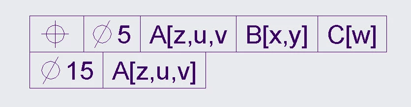

Does anyone know how to create a composite datum reference frame via syntax?
@[position]@[#@]@[A[z,u,v]@]@[B[x,y]@]@[C[w]@]
                  @[#@]@[A[z,u,v]@]
How can I carry the position sym onto both level of the syntax as you would see with a typical composite tolerance?

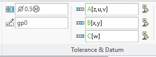

Best answer by TomU
This is Creo 4.0 M060 using the GUI.  (Sorry if I confused anyone.)

@BrianBoman
You mean something like attached image????
October 18, 2018
Something like this - currently I do not know of a way to encapsulate two rows within a singe "box"
Basically if you had this:
With the @[position@]
              @[position@]
creating a box out of two rows with a single positional symbol shown in this '2 line box' - see attached picture.
I was not able to do this with syntax.

@BrianBoman
I don't think, there is any option available for this..
