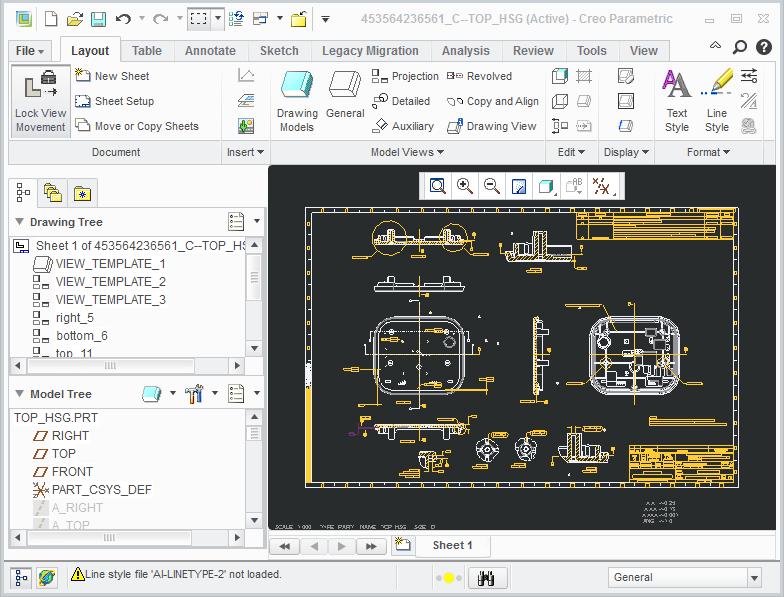

I have Creo 1.0 F000 installed also.
If you have all files closed in Creo there will be a System Colors button on the ribbon.
Click that and it will take you to the Config Options.
I just selected the "Dark Background" in the Color scheme dropdown.

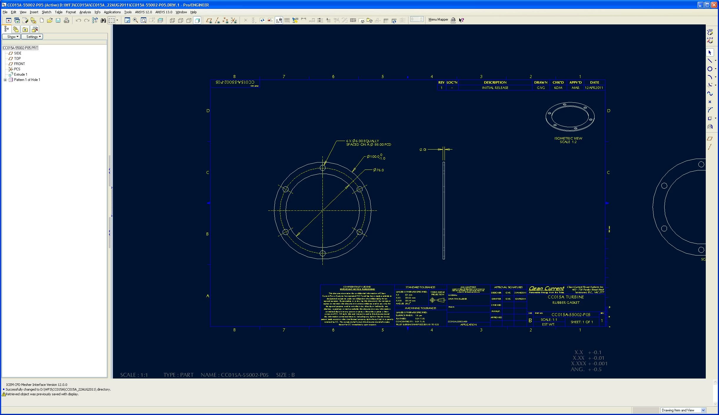

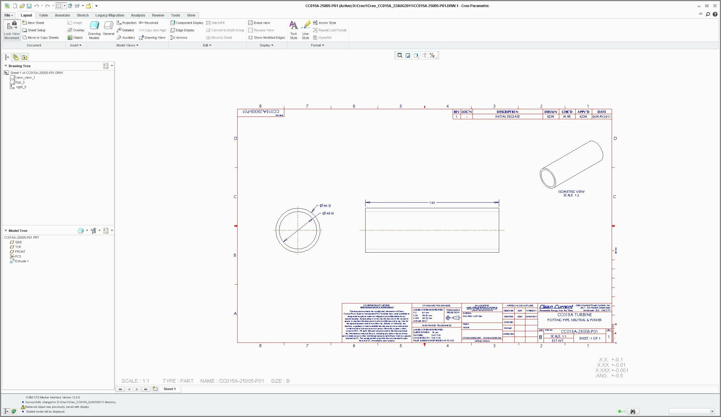

The attached untitled JPG is what I get (out of the box) with Creo 1.0 F000. am I missing something?
the second "pre-WF" JPG is what I'm currently using on WF3.
