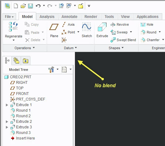

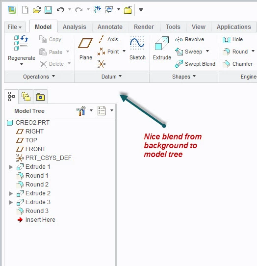

May 3, 2013 2:16 PM UTC
My users like the new colors and I personally do as well.
I completely understand how people have different preferences. The one thing I don't like about changing the colors away from the default off-white is that the model tree no longer blends into the graphics screen. With the default colors, you get a sense that the model tree is floating over the graphics screen but not when you change it.
It would be nice if PTC allowed the background section of the model tree to blend into the color you picked for the graphics area.
Maybe it's just me, but it bothers me. 🙂
I attached two pictures for reference.
