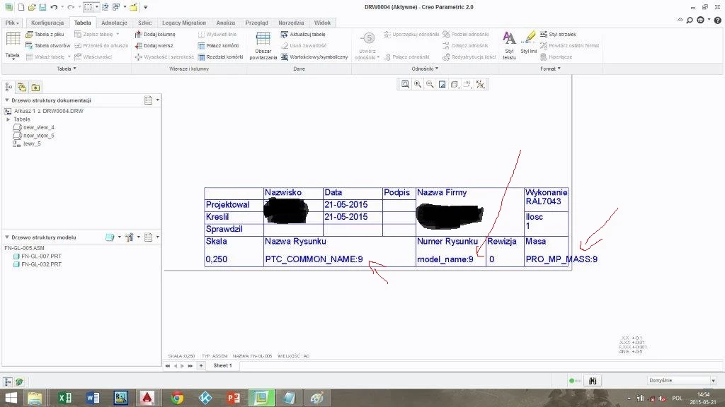

I have a little problem with table in Creo 2. I already create my ow table with commands like:
&scale
&todays_date
&PTC_common_name
&model_name
etc
I saved this table and when I want to use it again something wrong is happening like in picture in annex.
Also i woluld like change scale format to 1:4 not 0.25
