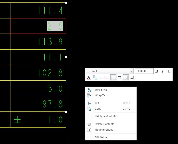

Hello all, I have been working with Creo 3 for a few days now & keep running into the same problem with some parameter values I have displayed in a table on a drawing. The table contains many cells, most of which contain 1 parameter value, but several cells contain 2 or more parameter values. The problem arises when I want to edit a value where a cell contains 2 or more parameters, I cannot select & change the required parameter. Where a single parameter appears in a cell, you can pick the value, right click, & edit value appears at the bottom of the menu that pops up. You don't get the same behaviour when 2 exist in a cell. I spent over an hour trying to figure this out this afternoon, to no avail. I ended up changing the parameter values in my models which was a pain, swapping back & forth between models & drawing.

John,
I just tried this in Creo 3 F000. It works just like WF5 in the sense that you can first select the cell, then double click on the specific parameter to edit it. This does work with multiple parameters in the same cell.

You are right, i came into to work this morning, opened up the drawing, & changed the parameter value. I also realized why i struggled yesterday. One of the values i was attempting to change was locked by relation, i just didn't notice the message warning me of this, it has been a while since i last worked with this master model & drawing. But i still stand by what is said yesterday, having 2 or more parameters in a cell seems to alter the behaviour, if you right click you don't see the 'edit value'.

You don't in WF5 either. Are you positive you get 'Edit Value' for multiple parameters in a cell with just the cell selected?
Single Value = Edit Value
Double Value = Wrap Text
