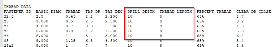

Hi dschenken,
I'm trying to integrate the parameters THREAD_LENGTH and DRILL_DEPTH in my hole-table, but this doesn't seem to work. (see attached hole-table; I've put ".txt" in the name, because otherwise I wasn't able to upload the file).
What I want to have, is per hole-diameter a pre-defined drill-depth and thread-length (to test, in my table this is for each diameter 10mm and 8mm):
In my hole table I still have the DEPTH_RATIO on top, but when I will remove this, my table doesn't work:

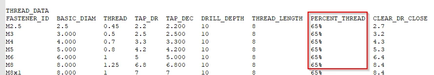

For the rest I don't really know what the parameter "percent_thread" does mean...
I've allready checked the link below, but this doesn't help me a lot: http://support.ptc.com/help/creo/creo_pma/usascii/#page/part_modeling%2Fpart_modeling%2Fpart_nine_sub%2FUsing_Hole_Charts.html%23
